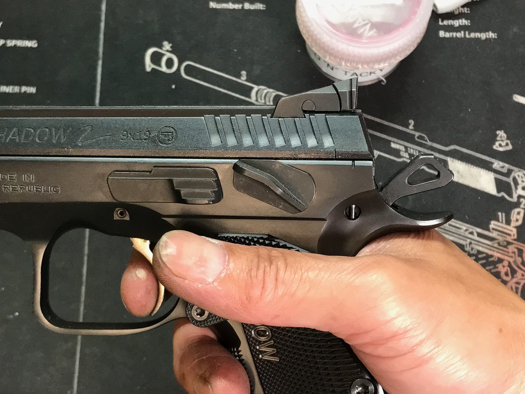

Figured I'd post this here since there was some interest in another thread. Be sure to wear eye protection as some parts are under spring tension.
Disassembly:
Begin with field stripping the pistol. Once stripped, gently lower the hammer. Do NOT allow the hammer to fall under full spring tension.

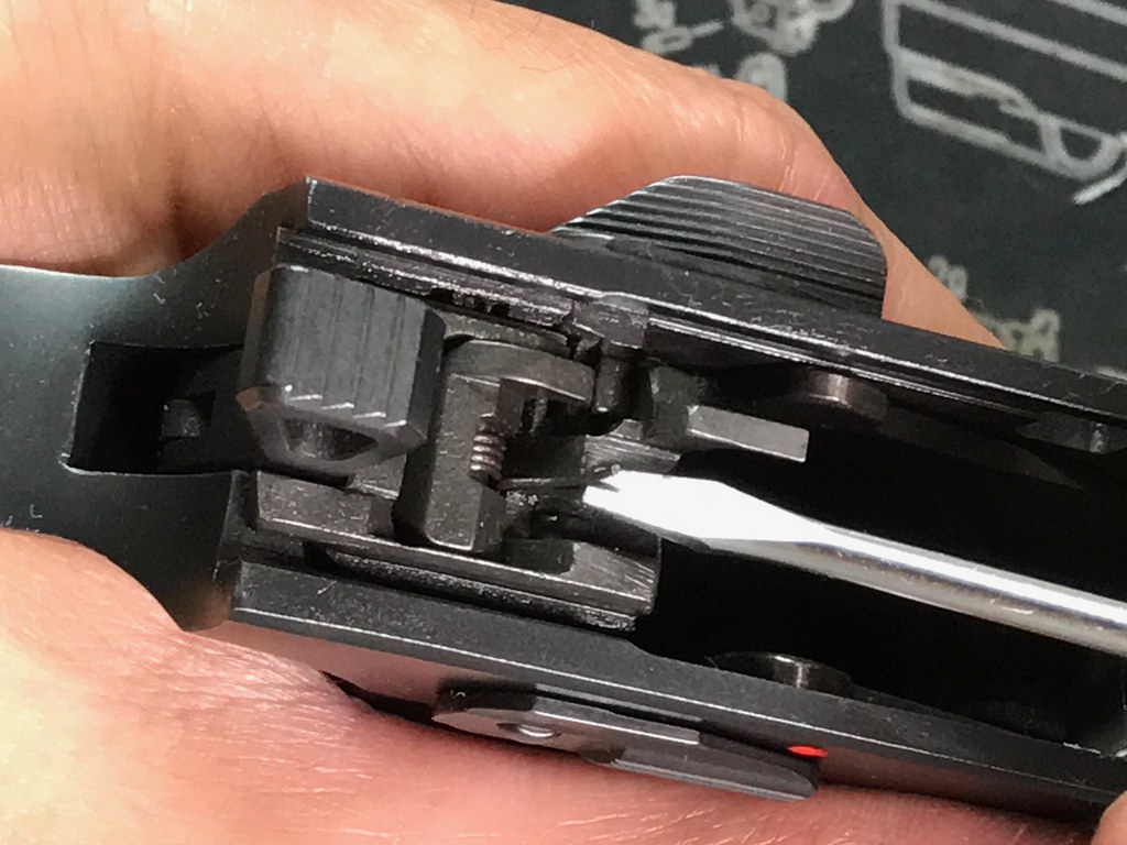

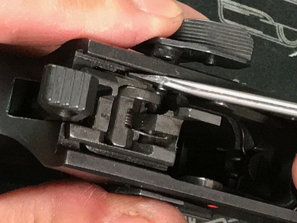

Using a small screwdriver, VERY carefully lift the arm of the sear spring and move it over to the side.

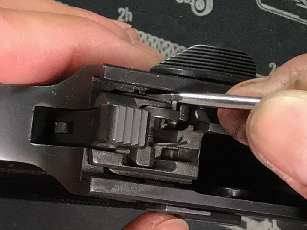

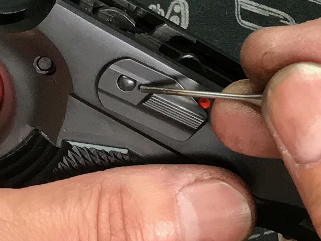

The next procedure requires two steps to be done simultaneously. Using a small pin punch or a small screw driver, slide the left-hand side safety detent towards the hammer while pushing in the safety's pivot pin from the right-hand side safety lever.
Place your left thumb over the ejector/sear assembly to prevent it from popping free as this part is under a bit of spring tension. Using your other hand, pry the safety lever on the left-hand side of the frame and pull it free.
Keep an eye on the right-hand side safety detent. This part is not under spring tension and can pop free if the ejector/sear assembly falls out.

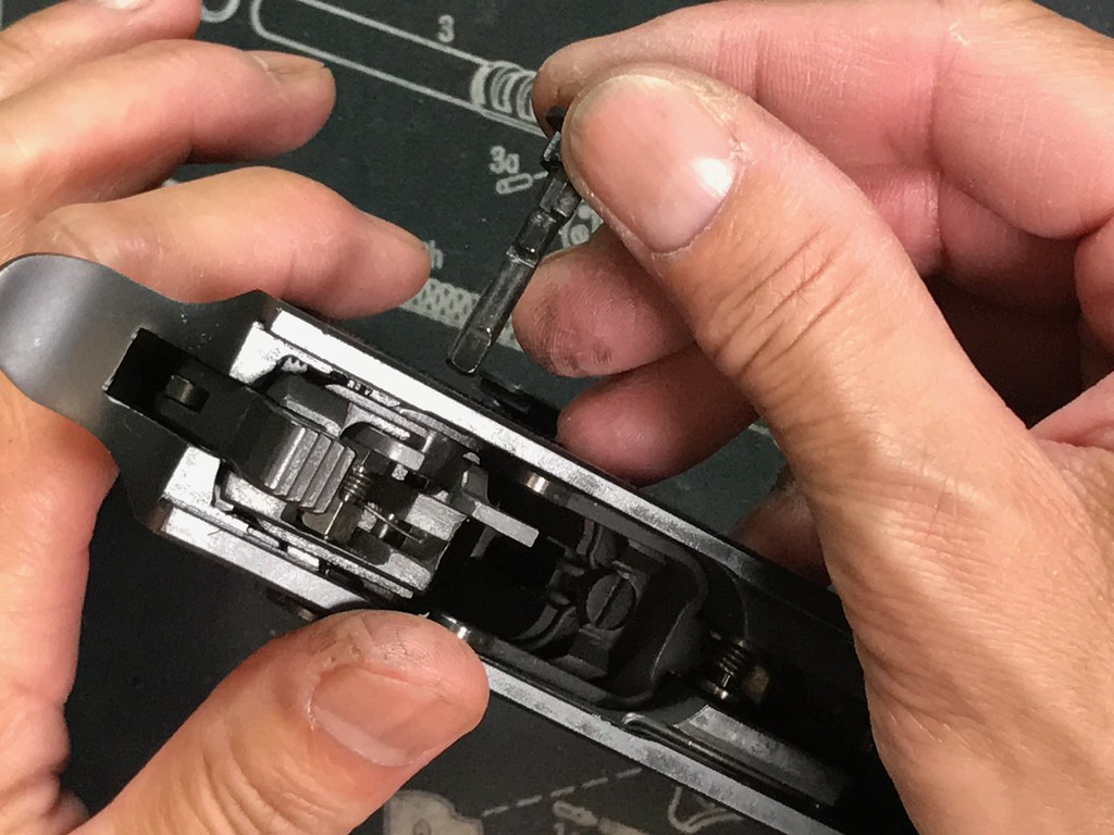

Reassembly

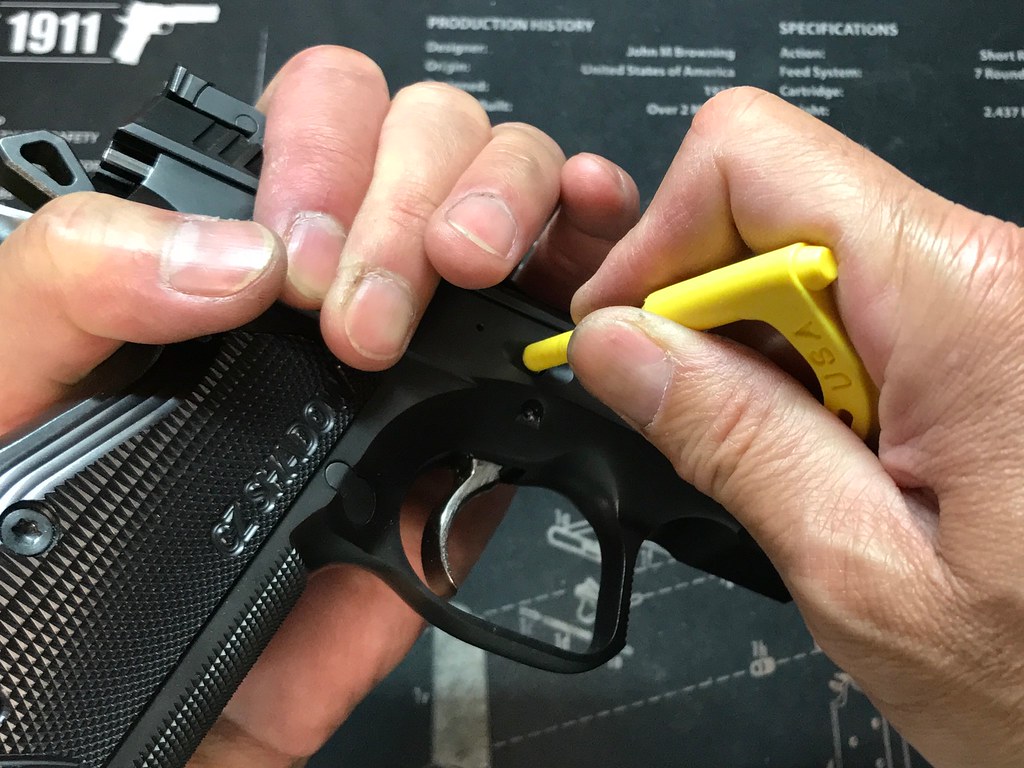

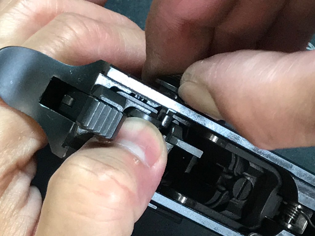

This step may take a few attempts the first time as it takes a little bit of finesse to perform. Place your left thumb over the ejector/sear assembly and up against the hammer. While pressing down on the ejector assembly, push back the hammer with the tip of your thumb so that the holes of the ejector assembly lines up with the safety hole on the frame.
Insert the safety lever until its pivot pin bumps into the sear spring which would have most likely have fallen back into it's proper place. The flat part of the safety's pivot pin should be able to slide under the sear spring arm but will be restricted by the shoulder. Rotate the safety lever downwards while pushing inwards. The sear spring arm should automatically ride over the safety's pivot pin until it is held up by the left side safety detent.

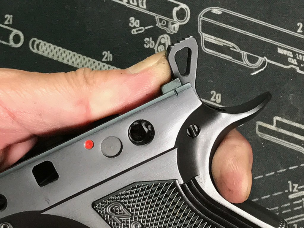

Align the "D" hole of the right hand side safety lever with the end of the safety pivot pin.
Using a small pin punch or screwdriver, slide the left hand safety detent towards the hammer while pushing in the left-hand safety into place.
Reassembly
