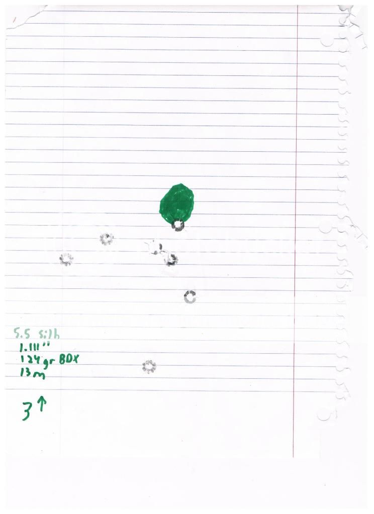

So after continuing to shoot after some evidence that my Shadow doesn't group, let's say 5000 rounds through this gun, I finally cooked up a variety of loads to see if it has a taste for something in particular.
13m, 7 shot groups with my arms resting just behind the wrists.
I only see one group there that I would consider decent, the rest are ugly. Time to try different brands of bullets and powder?
Just because you rest your hands doesn't mean you don't flinch a little. It could also be a vision thing that is preventing you from identically matching the green dot to your front sight evenly with each shot. Before you panic I'd suggest you get a known very good shooter to try the gun.
Having said that the Shadow is still a slightly adapted service pistol. It's not tuned up to shoot bullseye match level groups. For 13 yards it's likely a 1/2 to 3/4 inch group size gun even shot from a Ransom Rest.

I would have expected a slightly tighter group than that. But then individual guns could easily vary a little here and there.
Makes a person wonder what would happen if a Shadow were accurized in much the same way as with 1911's for match shooting. Namely slide to frame fitting, barrel to slide fitting so it seats back in exactly the same position, some form of barrel bushing added or otherwise fitting the muzzle to the nose opening and optimizing the headspacing.

Not to rip on you, but I am seeing a some half decent horizontal width groups but they are stringing vertically. It looks like you may want to work a bit on your breathing as you shoot; if I do not concentrate on that I get very similar groups. It usually takes 500-600 rounds in the spring to really get over it.
you are going about this kind of backward. Start with a target at 3yds, offhand (two handed, proper grip) shoot it. until you can can keep a tight group, don't move back. It's not the gun. Those buckshot patterns you've posted are almost certainly you, not the gun.
As for the Ransom Rest, unless they have a set of CZ grip panels for it, it won't help you in the least.
