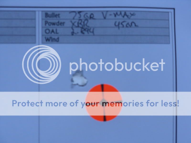

If my cross hairs are moving around I find by the time the shot goes off with a slow squeeze the cross hairs have moved from where I wanted them. In a situation like that I pull the trigger fast when I'm the sights are where I want them. This 3 shot group (114 yards if I remember right) isn't too bad.
