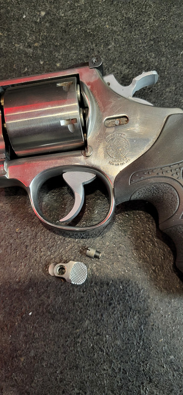

I went shooting today, took along my 627 and a box of Remington UMC .38 +P. Shot one cylinder, reloaded, shot 4 more rounds and cylinder latch falls on shooting bench, screw is sheared off. *sigh*
Shot the remaining two rounds, can't open cylinder to remove brass. Going to have to try carefully drilling that stub and using extractor to remove it. Anybody know where I can get a stainless replacement, or have one they could sell me?
Has this happened to any of you? There are obvious signs of metal fatigue, seems pretty shoddy on S&W's part.
Sonofa#####. And I really like that gun. If anyone has a better option to repair, I'm open to suggestions too.

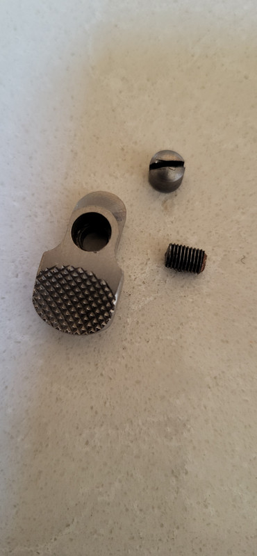

I'm a little slow. Finally figured out it is a cap, nothing to drill or extract. Thanks for info. A member reached out and has the part I need. I love CGN!
I am not a real fan of stainless, but that just me,
I am wondering if it was overtighten and that cracked the stud and it finally gave up and snapped off
The threaded post looks a little rusted near the base. Also, it's a little weird that the bolt is completely polished ("normal" bolt pictured below). I know there would be some rubbing over the years but there's no black whatsoever. Even the threaded portion that sheared off still shows some of the black finish. I'm not sure if S&W ever used polished bolts. Maybe someone with more experience can comments.
