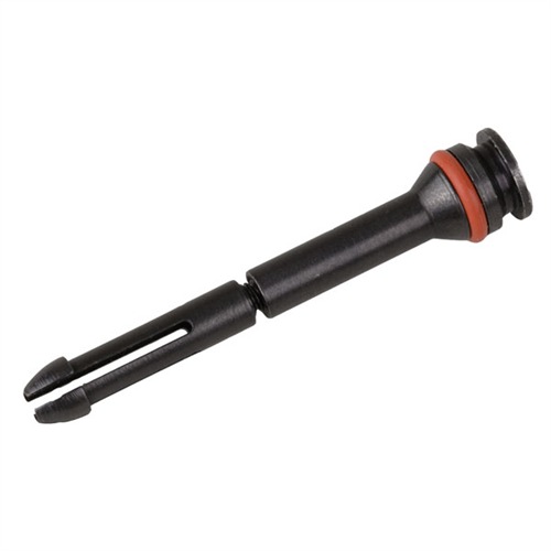

And one of these...
Home Depot for the brass rod. Comes in a 3' length and various diameters. I just cut it down to 26" and put a couple wraps of electrical tape about 4" from the end to help center the rod when it is in the bore so I'm knocking the bullet out from the tip and not wedging between the side of the bore and bullet. The remaining 10" cut-off I used for pistols.
The broken case extractor I got from Brownells. One for 223 (part # 080-000-441WB) and other for 308.
