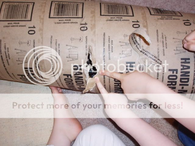

You pay an extra $1 (or is it $3) to mail a round tube. I like them myself. I have sent many oddball guns in them, and never lost one yet. Ask Tootall about receiving his....the kids thought it was a gift for them.

And as for the CP monkeys trying to bust up your stuff, they do try!
EDIT, I see Sten beat me to the post. Anyway, the sonotube has a drrawing of a swingset on it, as you might want to bury the legs in concrete. So my kids thought they were getting a swing set!
That would concern me
If I recall correctly, I used some foam as dunnage in that parcel. It wasn't enough to defeat the monkeys. That is why I recommend the filling of the parcel cavity with spray foam. It actually makes the parcel tougher.
