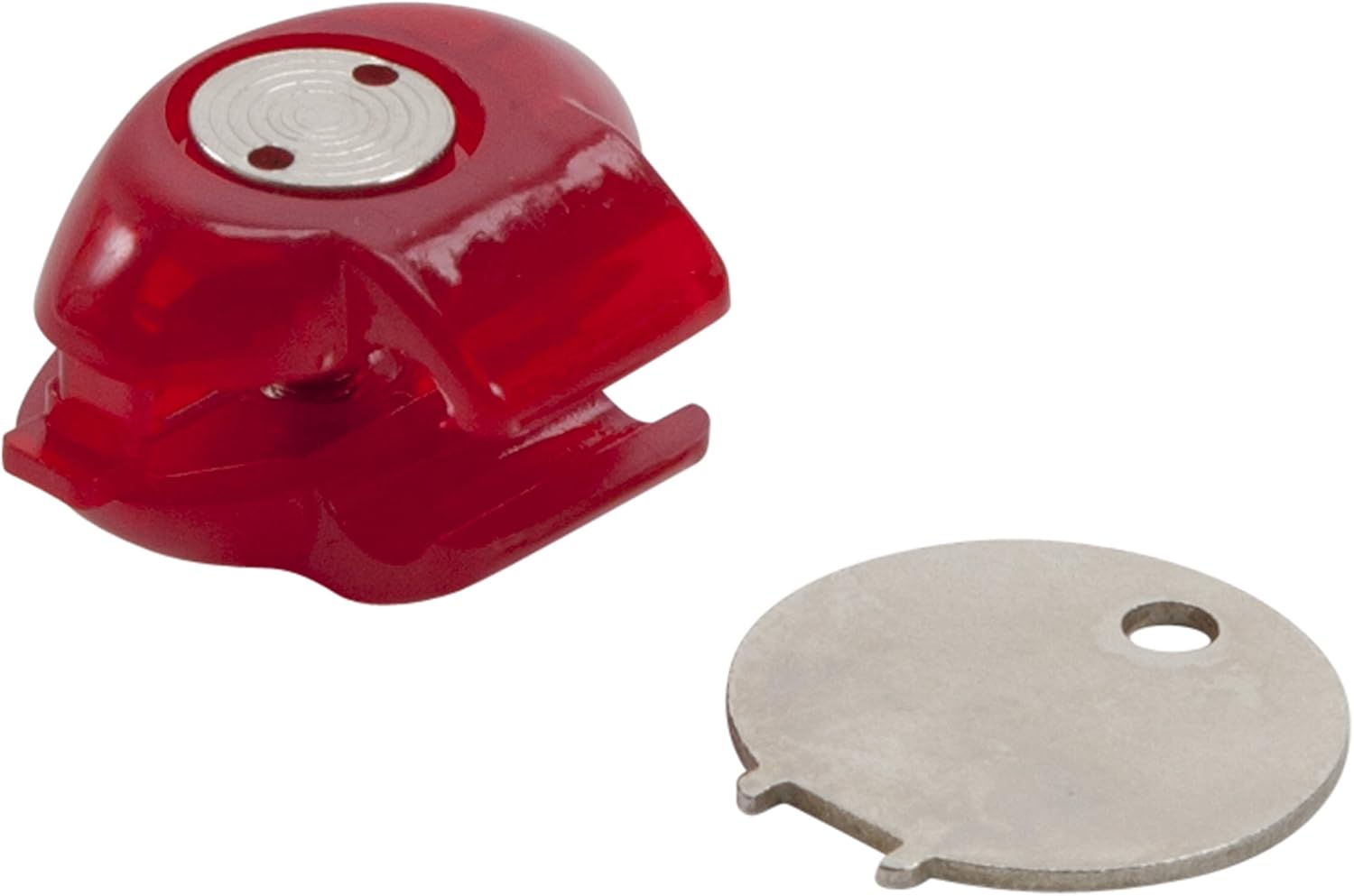

Use those cheap little plastic trigger locks. Then zip tie the case. I wouldn't charge the buyer for one of the plastic ones, but would for other more expensive ones and cable locks, though that's generally already factored into my asking price, if so.
This. I get a 4 pack of these at my LGS for about 6 bucks and there great. Just tape the flat key on an obscure place in the box and advise the buyer where it’s at.

The brand name for them I get at SFRC is Parkland and I recently got some from Williams Arms in Port Perry and they were a different brand name. Both sets were black. I’ve not seen the red ones before.
I have never seen those plastic trigger locks before...
I've never actually seen them for sale myself, but I keep acquiring them somehow...
These are what I use too. I call them $1 trigger locks, but that's a dated term now. I use there because they are cheap and easy and meet the definition of a secure locking device, which I don't believe a zip tie does. CP says attach a secure locking device, so I do. I even send the key taped to a piece of cardboard in an envelope separately via letter mail. I use combination cable luggage lock on the case, Amazon cheapies I got for $4 each. The verbiage is different for a locked case, so a zip tie may meet that requirement, but $4 isn't enough to worry about.
