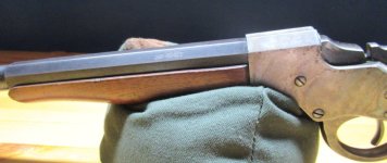

Been testing my Stevens Favorite No. 20's , Smooth Bore .22 Long Shot.
The results are quite rewarding after shooting .22 Shot in a rifled barrel.
Yea a good shot would use .22lr but SHOT reduces hole size.
....skwerl

Stevens Arms & Tool Co. are a little enthusiastic when they clam
a No. 20 in .22Long Shot is effective to 25 yards tho here are a]
couple targets stretching the distance out to 6 mtrs & 9 mtrs .
Using 50 year old CIL Whiz-Bang or New CCI ammunition has little
to no difference in shot pattern .
....skwerl
