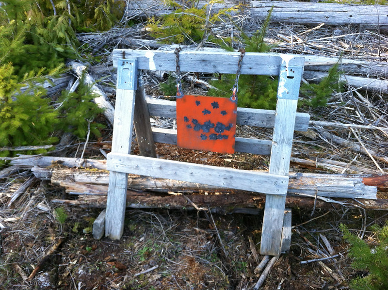

Here's a couple pics to give you an idea. I didn't make these, I got them through a group by on AO forum this sping. I would get more pics for ya but im currently up in Resolute Bay at work till the end of the month.

I would suggest using something other than rope to hang these gongs. The shrapnel from the exploding bullet will blow that rope off in less than 20 hits I would guess. Put a bolt through, and use chain on the back side.
Haha I have chain on there now, those were pics from just after I had got them and didn't have any chain lying around. The rope lasted 10 hits from a 535 grain postell out of a sharps at 400 yards. 535 grains makes a big splatter :)
