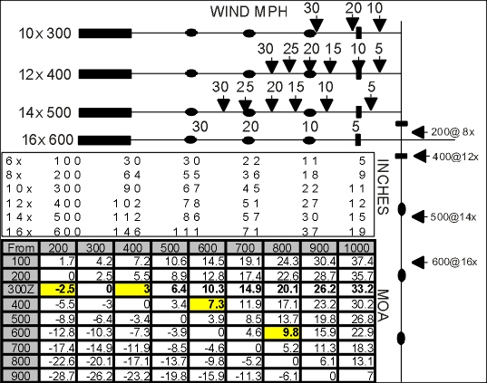

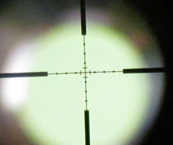

Mil-Dot. IMO the best reticle. Here's my attempt to photograph through my HiLux.
You get the idea.
What I did was to place my rifle in a cradle, put a ruler out to 100 ft, and at each zoom I recorded the inches each dot was on. I then extrapolated those numbers out to the respective distances I would set for each zoom. For example, I always use 10x for 300yrd, 12x for 400, 14x for 500 and so on. I then know how many inches each dot is for each distance as such in this.
This is all just mathematical, what may happen. I have yet to fully test this. But I do know it is close. Reality is always correct.
See this: http://www.mil-dot.com/media/1027/the_derivation_of_the_range_estimation_equations.pdf
