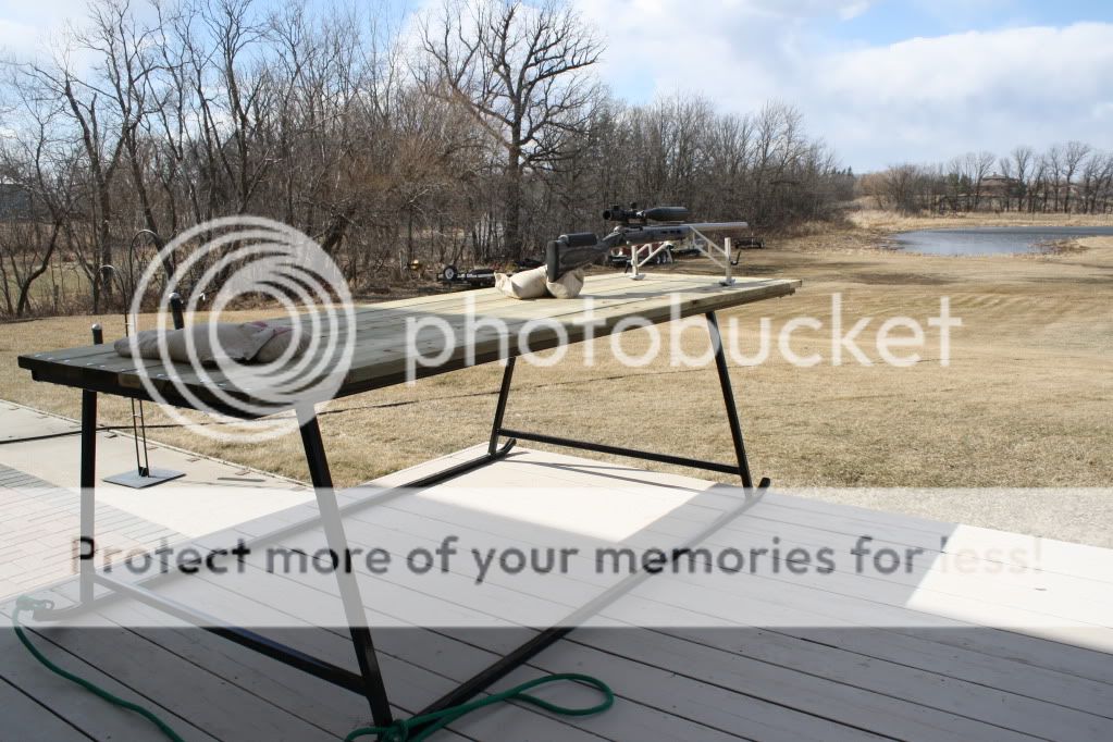

I live on the prairies and have a few fields where we can shoot a 1000 yards but the crops come up quickly, so here is my solution. It is 6'4" long at base to fit in an extended cab pick up and the top is 102". The base is wider than the top for stability and the ski ends are for placement by dragging it around. For those of you that are going to ask, it is a Sinclair bipod.

No problem, I welded the frame out of 1" tubing and used 5/4 deck material. The rope works to drag it around and to lift it on to the tail gate.
