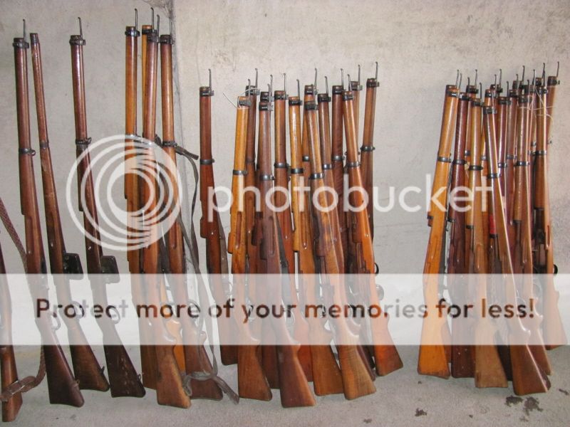

Guisan picked up quite a few stocks at a gunshow in Europe in the past year.
He had them "duffle bag" cut at a Barrel band to hide the cut and the joint.
This saves having to charge the $140.00 shipping cost each out of the Netherlands.
Some have come out really nice.

Re Stocks.
Guisan sold out of 96/11 stocks but still has for 1889, M1911, and K31.
$75.00 USD + shipping from the Netherlands. PM me for his email if you're in need.
