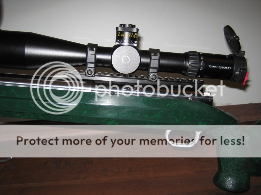

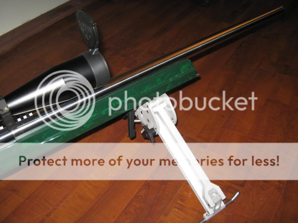

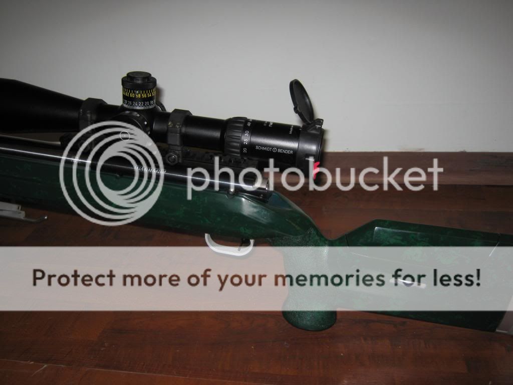

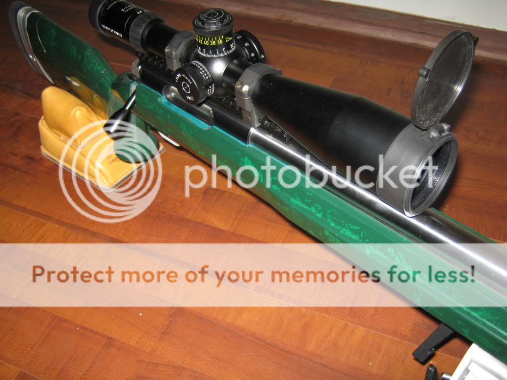

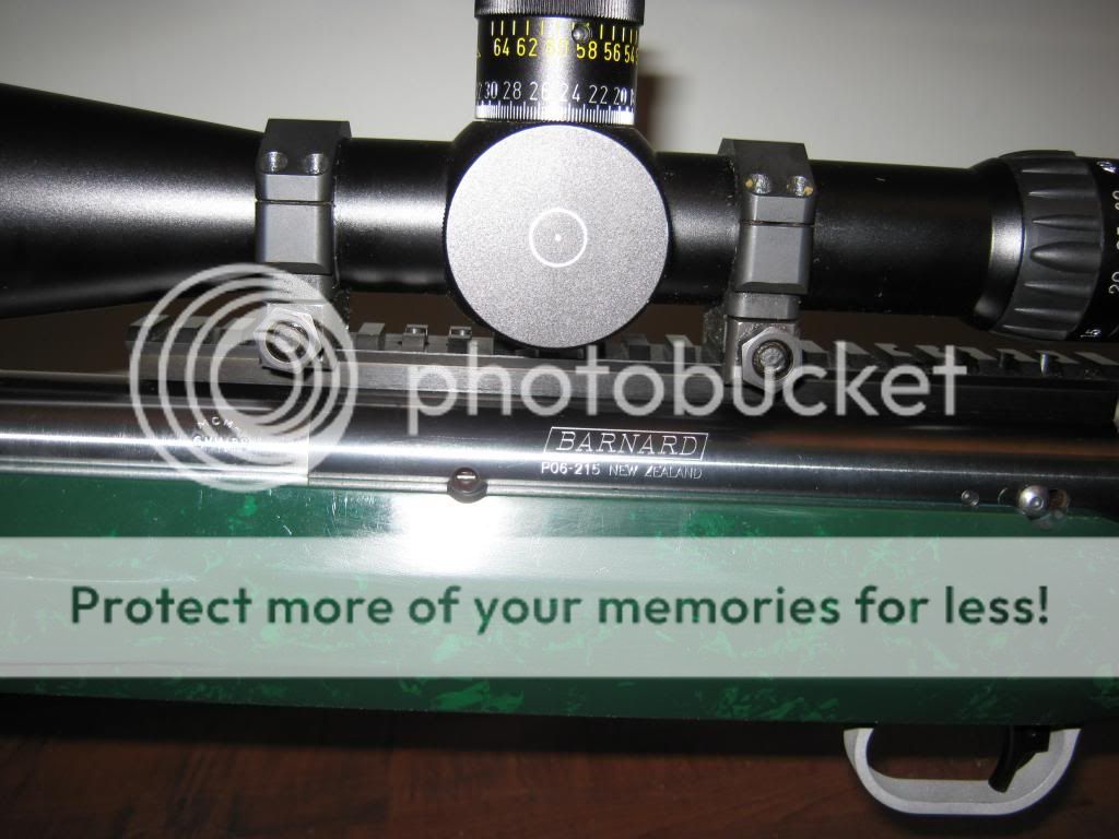

My new rifle is chambered in the very popular 6mmBR and is built on the very well regarded NZ-made Barnard single-shot action and sports a stainlessKrieger 5r 1:8 barrel.
All metal is housedin a green Robertson GBR stock – apparently one of the last sold in Canada –with an Anschutz rail and a fully adjustable butt-plate and cheek riser. All gunsmithing was done by Mick McPhee so you know it was done right.

It would be surprising if a rifle made by a smith of McPhee’s reputation out of such high quality components handled in any way less than stellar and I was not disappointed. The trigger (Barnard) broke crisp and clean and the recoil (55% of a.308) was almost non-existent given the weight of the rifle. The Robertson stock is a joy to use, everything fit me perfectly and the operation of the rifle could not be smoother. I shot off a Henry Remple bipod and found it to be every bit as solid with this rifle as it is with mylighter F/TR rig.
