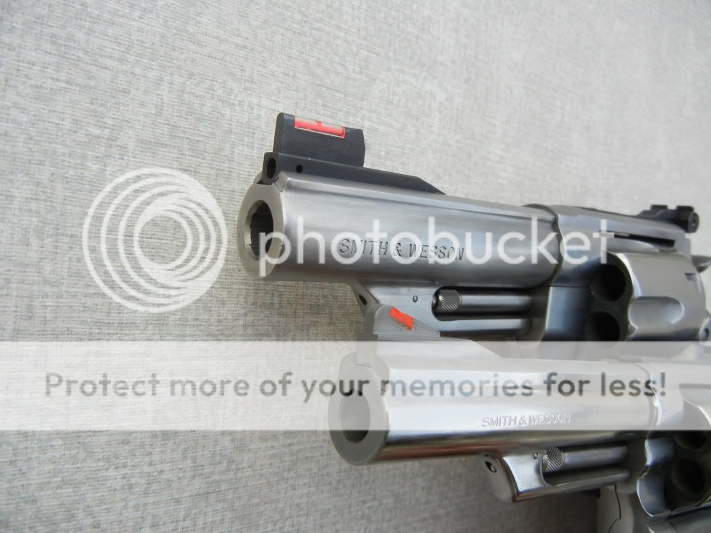

I bought this Model 29 from Armco in its shortened state:
It has the Weigand sight base that screws onto the barrel and allows for different sight blades to be interchanged. Shortening typically involves a new front sight.
Early Model 19s had the sight pinned in place with two pins through the rib. Later ones had the sight base integral with the barrel.
Cableguy, it won't work with a 19 due to the half lugged barrel. There's no extra lug metal to allow for the forward latch spring and pin. So a half lug barrel MUST be shortened from the muzzle.
the sight base is integral but its a fairly simple job to cut it out and mill an appropiately sized slot and reinstall.
Barry Jensen did both of these, the upper one has the weigand ramp that takes the newer S&W inserts
