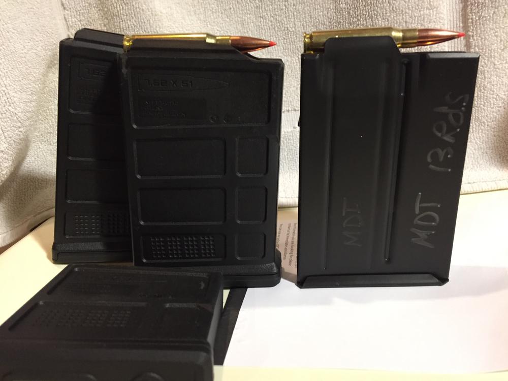

Here’s a picture of a loaded 13 rounder that MDT kindly sent to me.....

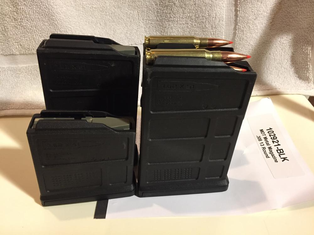

And a picture of the 13 rounder next to my Magpul 10 and 5 rounders
This 13 rounder is the same size as my other ten rounders. Looking forward to the snow melting and I can run this 13 rounder through its paces with my Magpul M700 308 SPS Tac
