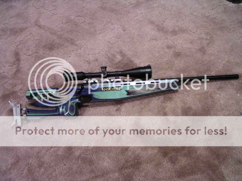

I mounted the 6.5-20x50 Conquest on my 1907 repeater last night, and this morning I shot it for the first time. My very first five shot group at 50 yards was right around .300", and the following groups averaged better than that, with a best of .210". The worst group fired was about .400", but most were in the .2" to .3" range. I was using SK Standard Plus loads, so I am hoping for even better accuracy with better quality ammunition. The good thing is, that the gun will shoot decently with affordable ammunition. The groups below are all five shot groups ,fired at 50 yards. I shot two 110 yards groups, that measured from .750" to .900", and both displayed some vertical stringing, that I am hoping will be lessened with better quality ammunition. The gun fed from the magazine just fine, but in 10% to 20% of cases, the case was extracted, but not fully ejected. I have ordered a couple of spare extractors, and springs, to use to try some modifications that supposedly cure this issue with the Anschutz repeaters.

In any case, I am quite pleased with today's results, I have yet to shoot a more accurate rimfire, and I am thinking that finding a more accurate rimfire repeater won't be easy.

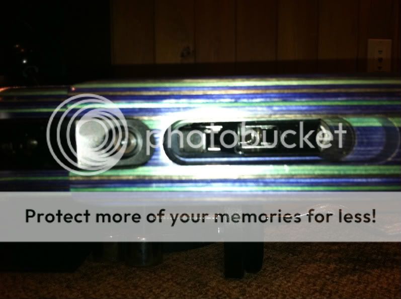

Can you show us a picture of the bottom of the stock where the magazine goes in? Does the stock have an accessory rail?

they are not common, special order only I do believe, and have been discontinued. Not cheap either, retail for just a hair under 3K. Stubble got a great deal.
Actually speaking to Peter at Target Shooting Products, he may have another new one available soon, for close to the price of single shot 1907 with a similar stock..
I have my name on one, asked for it months ago, and waiting for it to be built, another blue one like the op's. I do believe anschutz only has a few actions left. Just waiting for the stock to be built.
Hopefully yours will eject empties reliably, I am waiting for the parts to try to fix that issue with mine. I must say, that I do like the 15moa rail that came with the gun. It fits nice, and the clamping system doesn't mark the dovetails.
It better eject empties perfectly or its getting fixed pretty. No excuse for not ejecting. Heck my 50 year old target rifles still eject without any trouble whatsoever, surely technology has improved not worsened.
Is this a well known problem with this rifle or is it unique to yours?
My 54 Match ejects perfectly, but the repeaters use a different bolt than the single shot match rifles. Most of the Anschutz repeaters do not reliably eject empty casings 100% of the time. It is an ongoing issue that Anschutz has never bothered to fix. At least the fix is supposedly cheap and easy to do.
Simply installing new parts won't cure the problem, but a little filing supposedly will. I ordered two new extractors, and three spring clips, so I have spares to experiment with. The extractors are around $7 each, and the clips around $3 each. The procedure is below.
