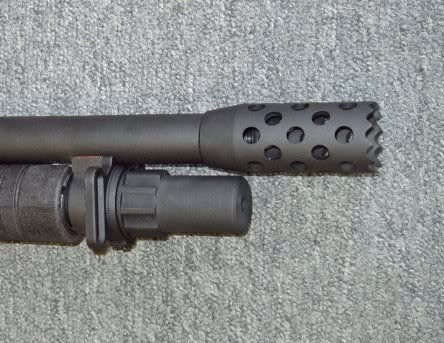

I was just wondering what it did if anything. Or if it was just to look cool. See pic below
I'm not an expert in this area by any means, but my guess would be that it would allow you to press that gadget/extension up against the door hinge or lock that you were trying to "breach" while still allowing the muzzle blast somewhere to go.
You dont really need it, We just use Regular 18" Rem 870 4 shot tubes and just keep the muzzle 1" from the door lock/hinge.
Also the rounds we use (concrete ones), you want the muzzle blast to help.
Also very handy for those that are stupid enough to try and grab your shotgun barrel.
Lee Hadaway formerly of Scattergun Tec makes a "muzzle guard" for pistols for a similar reason. Apparently police were running into gang bangers that would push the slide back on the cops gun so it wouldn't fire.

YES you do need one for safety if you are going to use it for breaching. Regardless of your intentions, a troop could push the muzzle directly onto the hinge and you could have barrel over preasure.
Also, if you have one, it makes it pretty easy to "aim"... Press and shoot...

The Fabarm muzzle brake looks pretty close to the device pictured. Of course all the Fabarm pumps have barrels threaded to accept one. most Remingtons are not.
I believe the breaching standoff pictured is right from the "Island Built" wedsite, aka DLASK. They make a copy of the Wilson, or whoever came up with the design first.
Its threaded onto the barrel.
