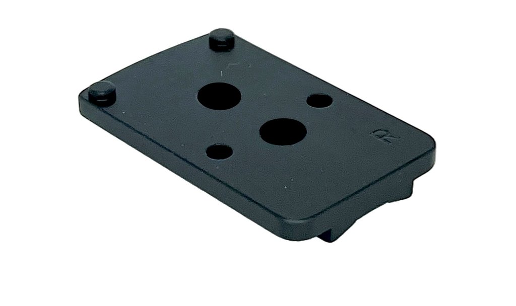

On the underside of an Aimpoint Micro (and clones with the same footprint) there are 4 screws, and a little square slot that interface with its mount, whether the Aimpoint factory one or any other.
If you want to cowitness irons, CROM smiles on us haha. Only game in town, but if you don't care about the irons as much there are options for half the price, like our own domestically made S&J Hardware versions. The two on the left are for Aimpoints, the two on the right for RMR style
Talley makes a very simple RMR mount as well, but I'd rather buy Canadian if possible.
