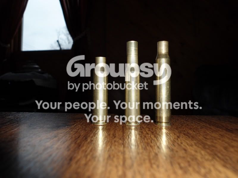

I had much to much time on my hands so for fun I ran a 30-06 case through a 308 die. As you can see once trimmed it would work. Not something I would reccomend, but possible. It actually resized relatively easily, just well lubed with RCBS lube on a lube pad.
One long cold winter i spent a lot of time in the loading room creating some odd combos. Never made a 300 girrafe but it looks intriguing. Put them on display then when an unsuspecting buddy asks about it string him along. :)
I actually did trim one, first I took a mini tube cutter to cut the most off then a Lee trimmer in a drill to finish.
If you plan on firing it, I would check the neck thickness before chambering a round. Might be a little on the thick side.

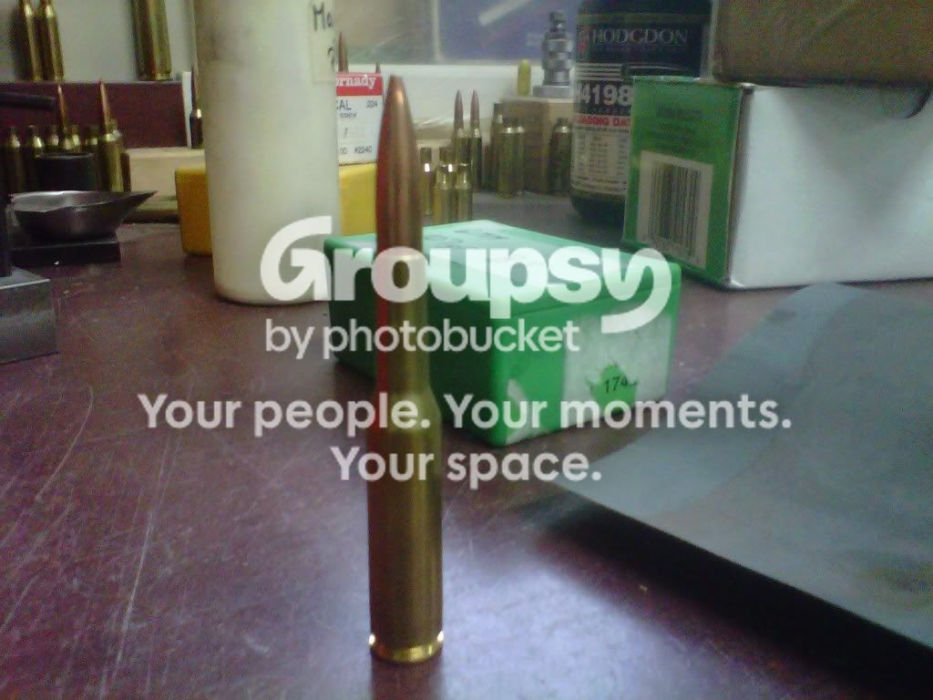

I was messing around one day and put a 270 case through my 260 die, then ran the neck through my 6BR neck die and seated a bullet into it. Looks really strange with a super long stepped neck. I still have it on my loading bench.
You certainly could just trim it and fire it (after double checking neck thickness) as my Cartridge Conversion book recommends using 30-06 to make 308 brass ... but I have to say, I like the idea of a 30-Giraffe better :D

Here is the one I mentioned earlier:
That is Awesome, i have seen a 308 Case that was fired out of a 30-06.... quite the opposite on the neck side of things haha.
30 girraffe looks good. would you seat bullets out as far as possible? lol
