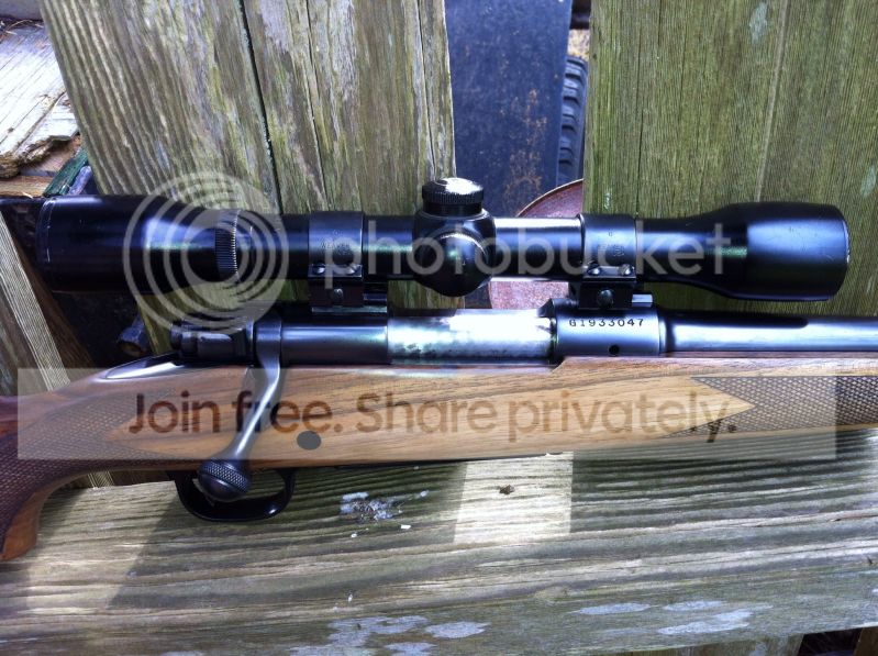

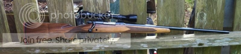

Just finished a little beautification of my Winchester Model 94 and Winchester Model 70 (30-06).
The Model 70 was made in 1969. I've left the wood in its natural colour, no stain, and coated it with Varathane Diamond Wood Finish Outdoor Gloss.
The Model 94 was made in 1979. It has been stained darker than original with Minwax Dark Walnut Wood Stain and the same Varathane coating.
I removed the original varnish from both using Circa 1850 Furniture Stripper.
Here they are:

Yeah, I was pleasantly surprised when I removed the old varnish on the 70 and was about to stain the wood. While doing some very light sanding and prep work I realized that it was actually a really nice piece of walnut in its natural colour! So I just put on a fresh coat of varnish and left it that. Didn't want to Bubba it. It looks exactly as it did before, minus a few missing, worn, and flaking areas of varnish. Probably looks much like it would have in 1969.
The Model 94 is real walnut, but it was a lighter wood that had been stained slightly darker. I stained it even darker, and re-varnished it. Looks better than ever. I picked that gun up for $250 back in 1993. I bet it's worth a little more now, but I'd never sell it so I don't really care about that.
