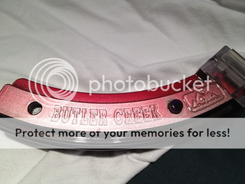

The first mag was supposed to be a blue base and red on top, then using a crushed plastic bag it separates colours, supposed to have the superman colour scheme. However, the paints didn't sit on each other well and turned pinkish purple, so my sister has now claimed it as her own. Anyone with a female shooter in the family knows they would love this one as a Christmas gift!

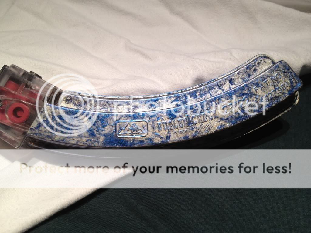

The second mag uses the same technique but with Mercedes metallic black, Mercedes silver and a BMW blue with a white pearl to make the colours pop without them mixing. If you look closely you can see the black at certain angles depending on how the lights hit it. Lots of paint went into this one, not a cheap venture for a small piece of plastic.

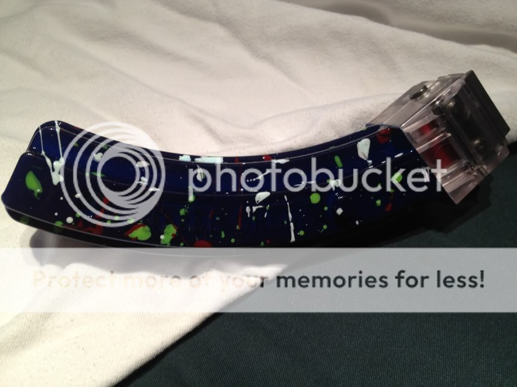

The third mag is the Jackson Pollock. It has Chev Impala blue with random left over paints splatted on it with about 15 layers of clear coat to even out the splatters. The clear is so thick you can barely feel the raised butler creek lettering on both sides.

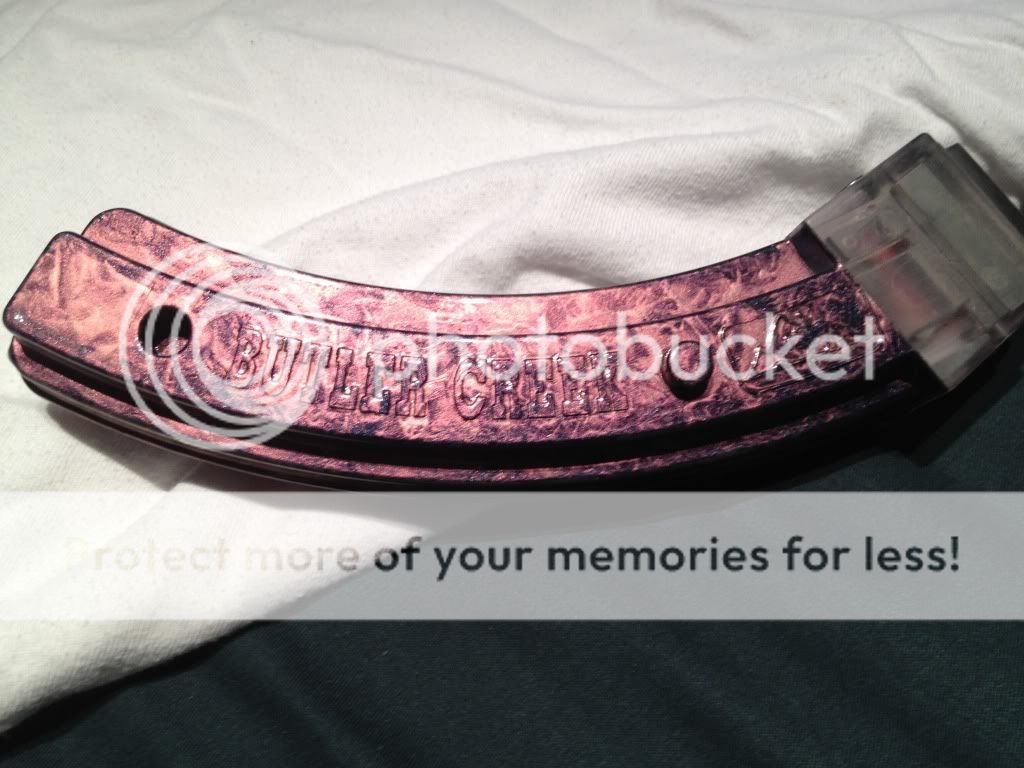

The fourth mag involved lots of taping and blending. The back side is VW metallic black with a Mercedes silver blend into a Cadillac red. The spine is a blend of the red and black making it look burgundy.
ceLL, did you have any problems fitting the mag into mag well?
I thoroughly taped mine anticipating the top of the mag probably wouldn't fit.
No problems fitting the magazine in the mag well, the only problem I can foresee is the paint will wear at the top faster though that may give it a more distinguished look.
I only bothered covering the feed lips, everything else just got painted and I had no issues even though I only let it cure for about 36 hours. That picture was after firing around 300 rounds and cleaning it.
