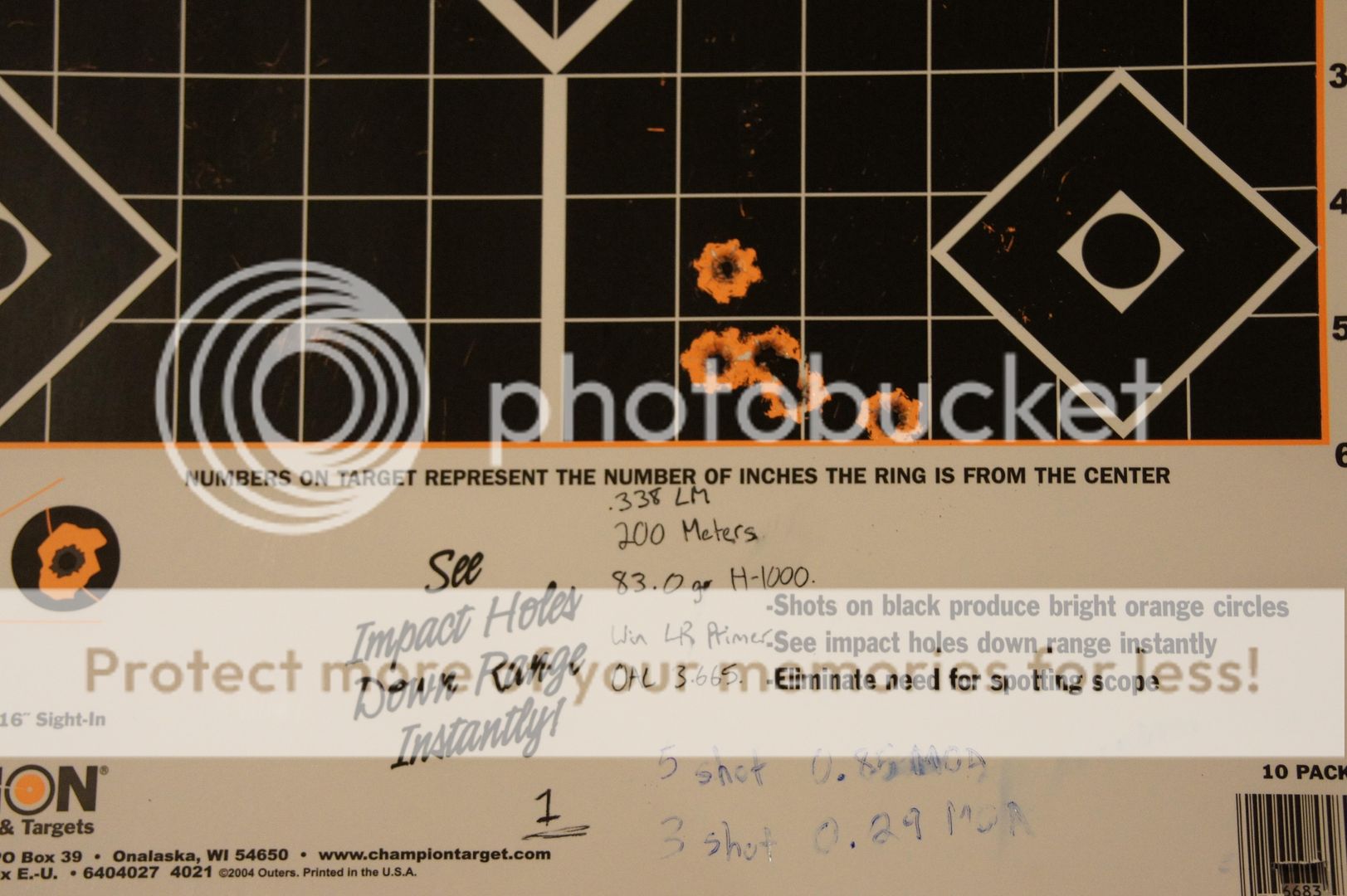

I have a couple loads now that are doing 1/2 moa but I know the DTA is capable of more so I'm still working on my load.
Here is the best group I've done so far. Hornady factory 250gr first day our with the new rifle. It should say yards not meters on the target though.
