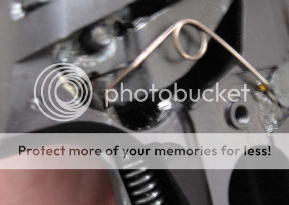

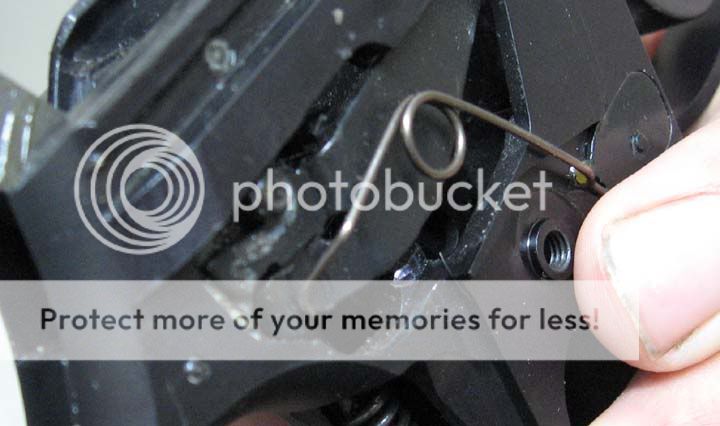

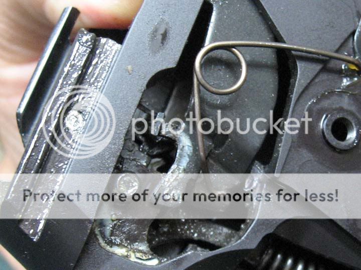

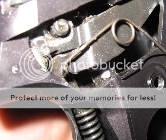

Hey I took the grips off of my sig today, and noticed this bit of aluminum being bashed by the trigger bar? Anywho, I doubt this is normal, and maby something is out of place? I have never had it past feild stripped, and I am the second owner, aprox # of rounds is 3000, its .40s&w.
Anyone eles care to look at theres and see if the same thing is there?

Could you post a slightly better pic so that I can see exactly which wear you are talking about? I see a couple of things that don't look right.
I'm a Sig armourer and former adjunct instructor for Sigarms. I have never seen that type of wear on any Sig handgun. Rather than look like an idiot beofre I know all the facts, I won't make any comment until I can see a better pic.
Well now that I painted it with a bit of marker, its not as shiny, but I basicaly suspect the trigger bar is peening the frame where that dimple is somehow. I have such terrible luck with auto loading pistols.. There is always something funky/bad happening.

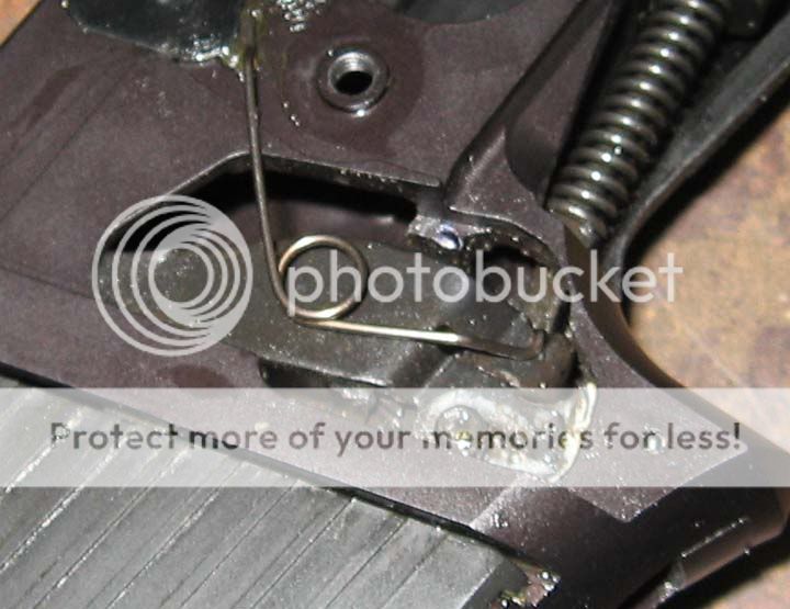

I just tore down my 226 and it has the exact same type of wear (I only have 3000 rounds through mine).
I played around with it and it appears to happen when a mag is inserted and the slide locks open under recoil (the trigger bar bounces down and off of that piece). It looks like it is there as a redundant locator for the trigger bar. I've never heard of or seen a malfunction related to this:confused:
I'm really not sure why this occurs nor why that piece is even machined into the frame:confused:
Just an FYI, I put over 90000 rounds through a P229 and the only malfunctions were due to parts wear (4 broken extractors, 3 barrels worn out, 2 broken firing pins and more broken trigger return springs than I remember... probably broke one every 8000 rounds or so). The frame had very little wear that would scare you so I doubt the 226 is any worse. I do recall the same type of wear marks in it though.
If it hasn't caused any malfunctions then don't worry about it, it looks like it will wear to a certain point then stop. It doesn't look pretty but what can you do?

I have 2 SIG P226s. One has this galling on the frame and the other one doesn't.
According to postings on sigforum.com, this is completely normal. To me something seemed to be out of spec, but the galling gets to a certain point and stays the same.
Both guns shoot fine.
Not sure what else to tell you. Enjoy the gun.
