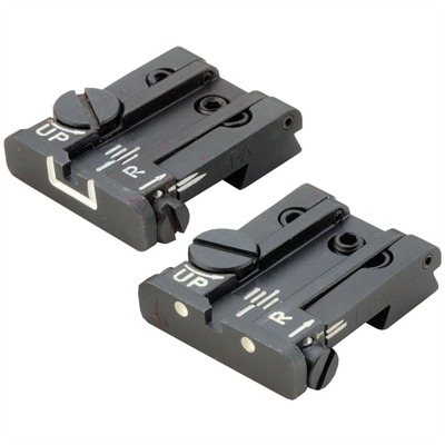

I had the same problem. I went over to The Shooting Edge in Calgary a bought LPA after market sights for a hundred bucks. Gun smith required. I also had a thread on this subject:

My P226 did this as well. The rounds impact the center to the white dot on the front sight. I was told this was a "combat" sight setup, though for me it meant I was covering way more of the target than I would like, so I swapped the rear #8 sight for a #10, and all is good.
The video is correct. Sig's have a "combat" sight set-up so the front blade will be covering where you intend to hit. You can change the point of impact by changing the sights if you like from the factory set-up to something else.
thanks, carbonrod. where did you get the #10 rear sights? any issues with the replacement process?

questar has different rear sights available and they can special order any factory sig sight you want, be patient and just replace the back blade for another Factory Sig Nightsight.... you would need a taller rear sight...
I know on the glocks each + or - sight gives approx 3inches of movement at 25yds... sigs are probably similar.
