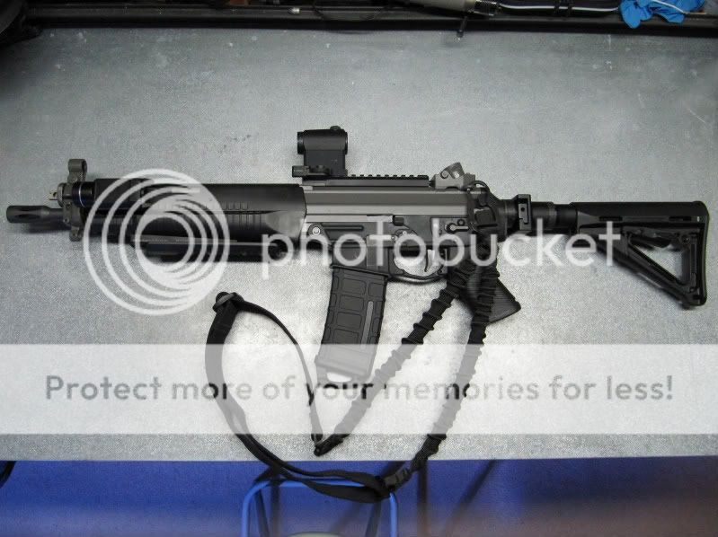

I see these for sale on US forums everywhere for dirt cheap. 2 questions;
1. Fit on a Canadian spec PE90?
2. Any way to get paperwork to legally export these out of the US?

Well those that have done this do say that these lowers require modification to the PE-90 upper to work properly. I'm not sure if this would be a drop in replacement lower.
I would be interested in real world experience with this however. I have to admit that I'm just repeating what I've heard and haven't tried this myself.

Yes you have to do the relief cut to the upppers trunion area. A 5 minute job with a dremel, then works perfect with AR mags.

Well there's no going back from that :runaway:. Thanks for the claritiy on this, I've been wondering for a while and just not willing to commit without full knowledge.
Makes those pricey 553-us lowers look more appealing for the ability to drop in a lower that takes STANAG mags and retains the folding stock without modification to the upper.
Any reports of this modification to the upper causing reliability issues or weakness?
It has no efect on reliability at all, you can also notch the mags if you dont want to touch up the trunion with a file or dremel.

Been reading more into this and one of the few US owners of a Swiss dropped on a SIG-556 lower and claims it works with PMAGs just fine, no modification to the upper (which down there makes Canadian swiss prices look cheap I'm sure you're aware). Any truth to this claim you figure? With the prospect of polymer Beo mags I'm not dissapointed so much by the innability to not use LAR-15 10 rounders if this holds any truth.
