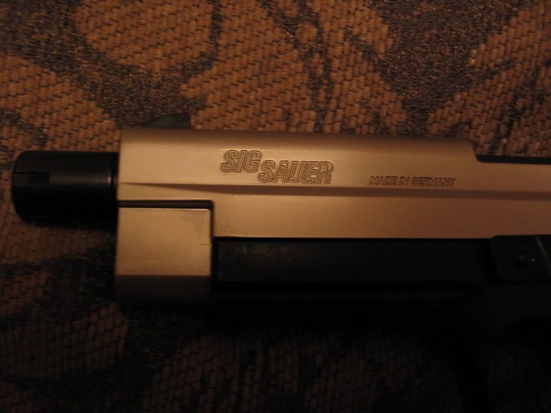

I still can not understand why everybody is referring to these guns as Sig Arms? Mine says Sig Sauer, Made In Germany. If the Americans are stuck with an inferior copy what does that have to do with my gun?
