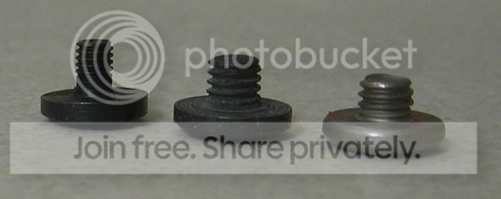

First thing is... I have both the 228 and the NP-34. I am not sure the NP-34 grip screws are the same. Does anyone know for sure? If not, I could take the grips off my NP-34 and compare the screws to some of the SIG screws I have. My thought is that the Norinco ones are a little smaller - but that could just be perception. The way that the threading is put into the Norinco frame is different from the way it is done on SIGs. It looks like a brass insert in the aluminum frame:

Thanks for the links. Now I just need to know if the screws are the same size or not. Do you think you could compare the real ones to the clone for me?
I hate to ask but I'd also hate to order the wrong parts.
Thanks!
Matthew
I had a look at it. My recollection was correct. Don't order SIG screws, they will not work. I think your options would be: (1) contact Marstar and see if they can somehow hook you up with some of the Chinese NP-34 screws; or (2) take one of your NP-34 screws to a really, really big hardware store and see if they can come up with something compatible.
Left to right: NP-34 screw; OEM SIG screw; aftermarket torque screw for SIG guns:
