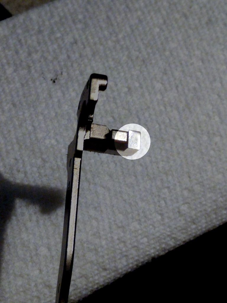

As an FYI to anyone who has a SIG P320 with the dreaded "Double-Click" (Youtube it) ...here's the fix.
As far as I know this post will be a first with information on how to solve the "problem."
*Warning* depending on your skill level, you could botch this and require a new TRIGGER CONNECTOR (SIG PART# 1300675-R)
Ok here we go...
The problem is that this face is too tall, mine originally measured .306"
So what happens with the double-click is the that sear is released first... then, a long-trigger-pull later the disconnect activates producing the "double-click."
The problem with this is that is feels like garbage and one could potentially induce a failure (i.e. a dead-trigger after firing a round.)
SIG apparently claims that this is normal, yet, not all P320s have this problem (but a lot do.) I'm thinking it's a lot cheaper to say it is normal, than send out a $60 part to everyone who has the issue. :p
The FIX:
I ended up reducing the height to .296" which tightened up the point at which the disconnector is released. The SEAR and DISCONNECT now happen within a millimeter of each other and is indistinguishable on trigger pull. The DOUBLE CLICK is Gone. :D

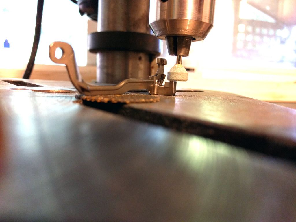

Not one for attempting to hand-file a flat-face, this is what I came up with... the "poor-mans" mill; note Dremel cutting-disc under TRIGGER CONNECTOR was used to make for an as close to perfect level surface as possible.

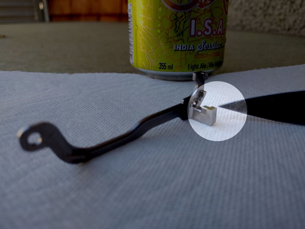

Here is the face after with a little polish. Careful not to round the front-edge in order to maintain as crisp a trigger pull as possible. Enjoy!
I should add... Remove a little first (.002"~.003"), then dry-fire, repeat until just one "click" (i.e. release of firing pin, followed by disconnect as one motion) is heard/felt.
It's actually always two-clicks for every P320 ever made (firing-pin release, then disconnect), but when they are close enough together it feels like one. Keep that in mind :)
