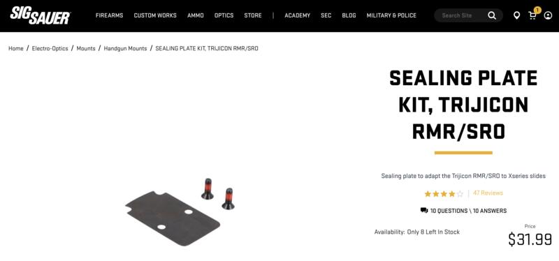

I'm mounting a Holosun 507K Optic on a Sig P320 X-Five Legion and it looks like I'm missing an optic sealing plate (see below).
Anyone know where I can get this? They are in stock at Sig but they don't ship to Canada.
Note: The optic mounts directly to the slide even without this plate but the original adjustable rear sight screw holes are exposed.

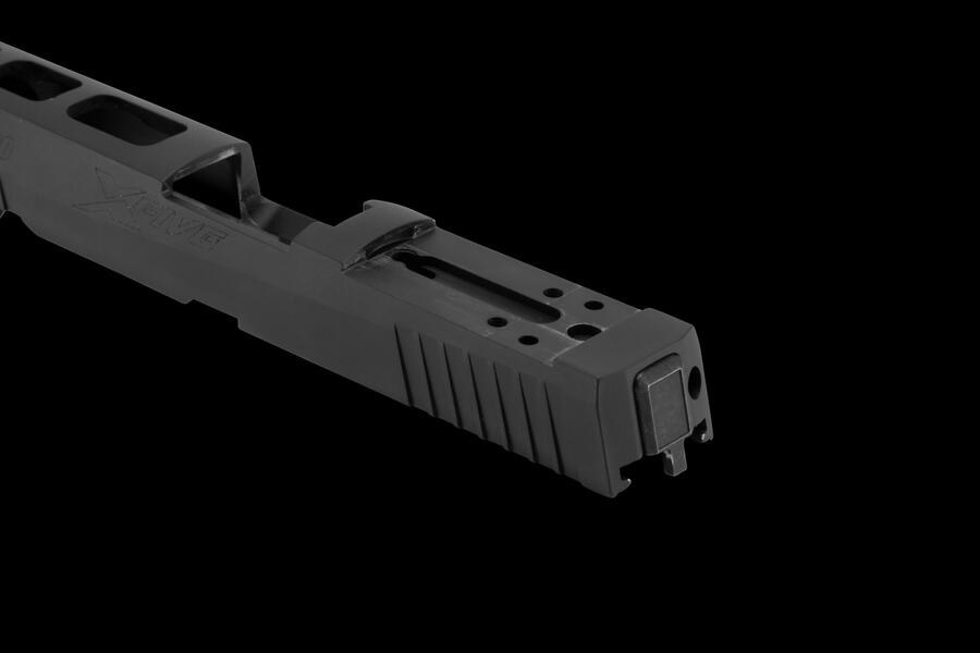

Note the notched section that covers the rear sight's screw holes. The other plates discussed here don't do that.
Here's the area that I need covered.

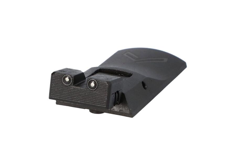

Here's the rear adjustable sight that was removed.

You are missing the point. The sealing plate is only meant to seal the RMR battery compartment, it is the same exact size as the RMR and will not cover the rest of the cutout. The footprint of the RMR/SRO/Holosun optic is smaller than the cutout on the X5. The reciprocating force will be felt on the screws only and they will shear off in a short amount of time. The filler plate is meant to give the optic a bit of metal to sit against to distribute the force away from the screws.

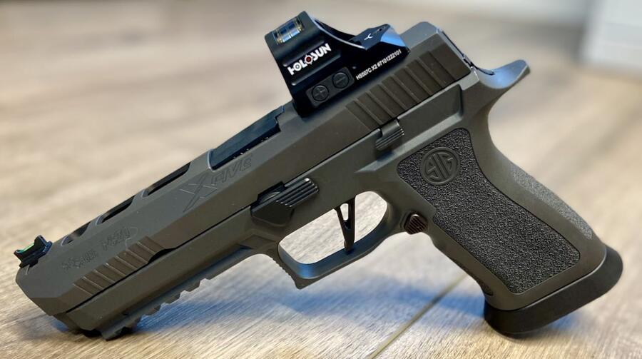

Just finished mounting the 507C. 507K is going elsewhere. Thanks for the advice everyone.

That 507c is a smooth direct fit on your Legion!
