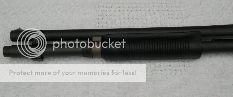

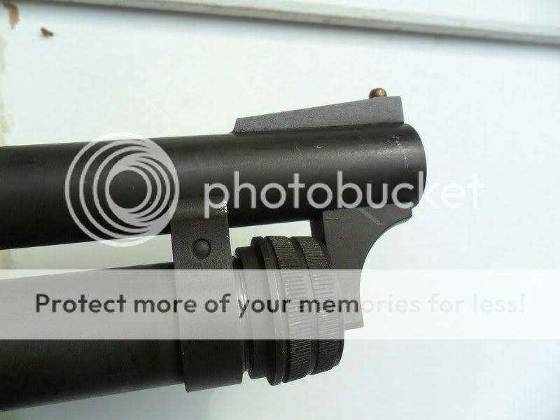

I notice that many relatively short barrelled smoothbore shotguns shoot slugs high for point of aim.
One way manufacturers addressed this is by putting the factory bead on a ramp or pedestal.
This Ithaca was modified by the previous owner for that very reason:
And this 870 came this way from the factory for the same:
