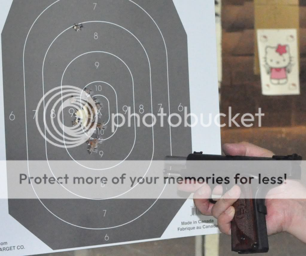

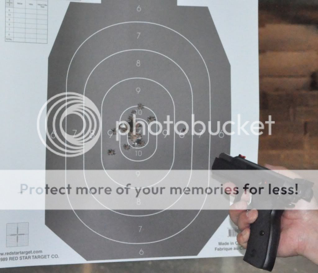

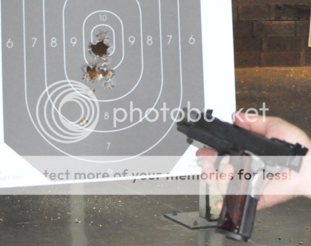

Got out to the range over the weekend and spent some time playing with sight pictures #1 and #2 on my Targetmaster. My experience was bang on what Cocked&Locked mentioned. I could group much more accurately/repeatably with sight picture #1. But thinking about it, I believe sight picture #1 will be more affected by target distance. If you look at the diagram I sketched up below, I can adjust my sights to target distance A for both sight picture #1 and #2. But if the targets move back to target distance B - without readjusting my sights both sight pictures would give me some error, but sight picture #1 would be off by ~50% more. Please keep in mind that it's a quick sketch and not to scale. Could work out the math, but can't find my scientific calculator.
So net is, I'm gonna shoot sight picture #2 on my Shadow and Trojan as the sights pretty much came setup that way from the factory. And I'm going to use sight picture #1 on my Targetmaster and just adjust the 3 Aristocrat rear sight presets to 10, 25 and 50 yards.
