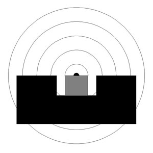

What you're describing (lighted target, dark firing point) is actually the best for accurate handgun shooting. Three dot sights are meant for speed not precision--what you need to do in your case is line the front sight up side-to-side in the middle of the gap of the rear sight with the top of the front sight level with the top of the rear sight...let me see if I can find a picture.
This is not my picture but give you an idea of what it should look like:
Don't focus on the target--focus on the front sight.
