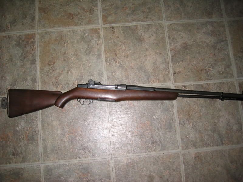

Well my Bubba'd Garand showed today. Of course after the initial gasp and gag, a tear down immediately followed. Interesting finds indeed. Summer '41 production. Bolt, op rod, hammer, trigger group, gas cylinder and lock bar sight original and complete. Not one part is incorrect except the barrel. It's a '51 SA. I'm starting to wonder if this was an arsenal rebuild. If it was, an armourer paid meticulous attention to replacing stuff with original correct parts... highly unlikely in a time when no one gave a damn. The barrel throws me off, coulda been done anywhere, who knows though.
Now the fun stuff. Bubbs did me the favour of eliminating all the pesky fore end wood, and then smoothing the stock nicely at the nose, exposing the fine operating rod for all to see.

Then, bubba carved a fine pistol grip in the stock, actually doing a fine job of it if it wasn't a travesty of course.

All in all, I'm not dissapointed. I need a new stock, front sight, and a rear sight cover. I'm a big fan of the NM rear aperatures, so I may try to snag one of them. The barrel looks passable, but it needs a good cleaning. The op rods runs freely, no binding issues at all, even though the action was as dry as a popcorn fart. Oh yeah, it mic'd in well within spec too. Just the kind of project I was looking for. Mild surface rust over quite a few bits, no pitting though. A good cleaning is in order.
So, the eternal question... Repark or not to Repark?
