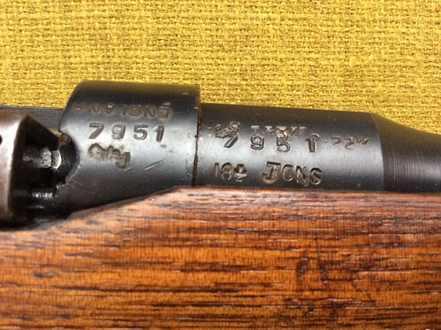

I can make out a faint stamp of '18 1/2 tons' and '2.22"'. In this same area I can faintly see ' 3" '. Would this be the remnants of a '.303' stamp?

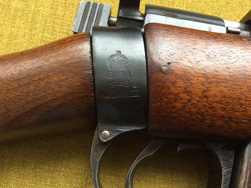

I think your assumption is correct. Here are some stamps from my '43 GRI:
[/URL][/IMG]
