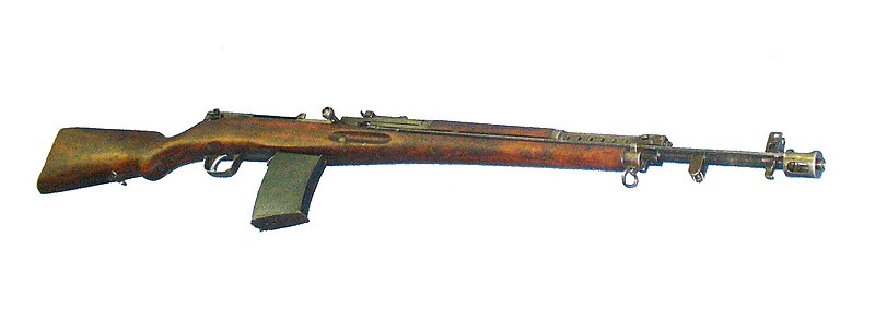

I'm going to argue with the idea that the SKS has nothing to do with the SVT. Tokarev was at one time Simonov's supervisor as was Federov. This is most likely where the short piston gas system for Simonov's rifle designs came from, since Tokarev was working on this at the time.
If you compare Simonov's AVS-36 to the SVT-38 they look almost identical. With one major difference. Tokarev used a "tilting" bolt design while Simonov didn't.
AVS-36

Which came after the AVS-36 and the SVT. The PTRS41 borrowed most of it's design from the AVS-36 rifle. With one major difference. Now like the SVT-38 Simonov incorporated a tilting bolt design. Frankly I would consider the gas piston system and the tilting block design as being "borrowed" from Tokarev and the SVT rifles. I would argue that the SVT had a major influence and is actually the Grandfather of the SKS rifle.
