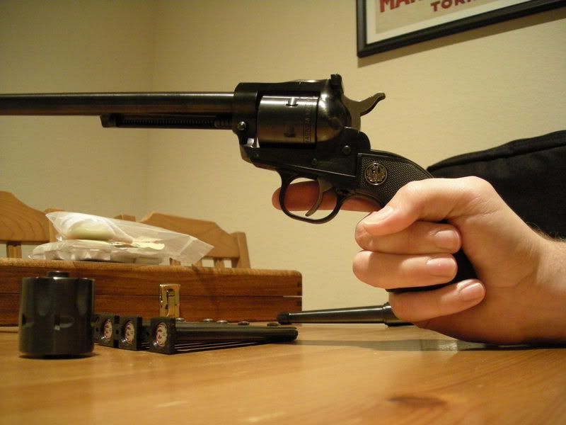

It's basically a two finger grip with the pinky going underneath the beveled lower part of the grip. The pinky underneath helps counter act the torque of cocking the gun when firing with one hand.
I've used the pinky finger under the grip in the past, which works for a few rounds but after shooting some heavy 357 or 45LC loads, my pinky takes too much of a beating and the nerves get hammered to a point where the tip of my pinky starts to tingle. I've since switched over to the thumb on the recoil shield method like in the vid below.
Your pinky should not be hurting, do you let the gun roll back? I have shot 44mag with pinky under method and it was very pleasant.

It rolls back a little but not a whole lot as my pinky usually arrests most of the recoil. Am I supposed to let my whole had roll back with the recoil. I got somewhat thin, bony fingers, not sure if that doesn't help with the padding. I used to grip it just like in Can-Down's pic but the nerves right on the knuckle under the grip is where it gets the beating making my finger tip tingle. Never had a problem with it in the past but the pinch only started showing up during my last couple range sessions when I shot a lot more ammo while testing out new loads.
