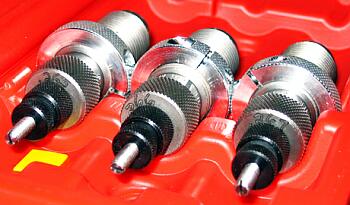

Just remember that a honed Forster die will restrict you to one brand of case or neck turned brass. Below this reloader had three honed dies which to me is not needed for the average off the shelf factory rifle. Also note in the photo below the expanders are still being used to uniform the neck diameter. In the Redding bushing FAQ they tell you if you do not neck turn to reduce the neck .004 more than the loaded diameter and use their expander to push the neck thickness variations to the outside of the neck.
FL Bushing Dies vs. Honed FL Dies
https://www.accurateshooter.com/technical-articles/reloading/fl-bushing-dies-vs-honed-fl-dies/
Forster FL dies, necks honed to .265″, .266″, and .267″.
