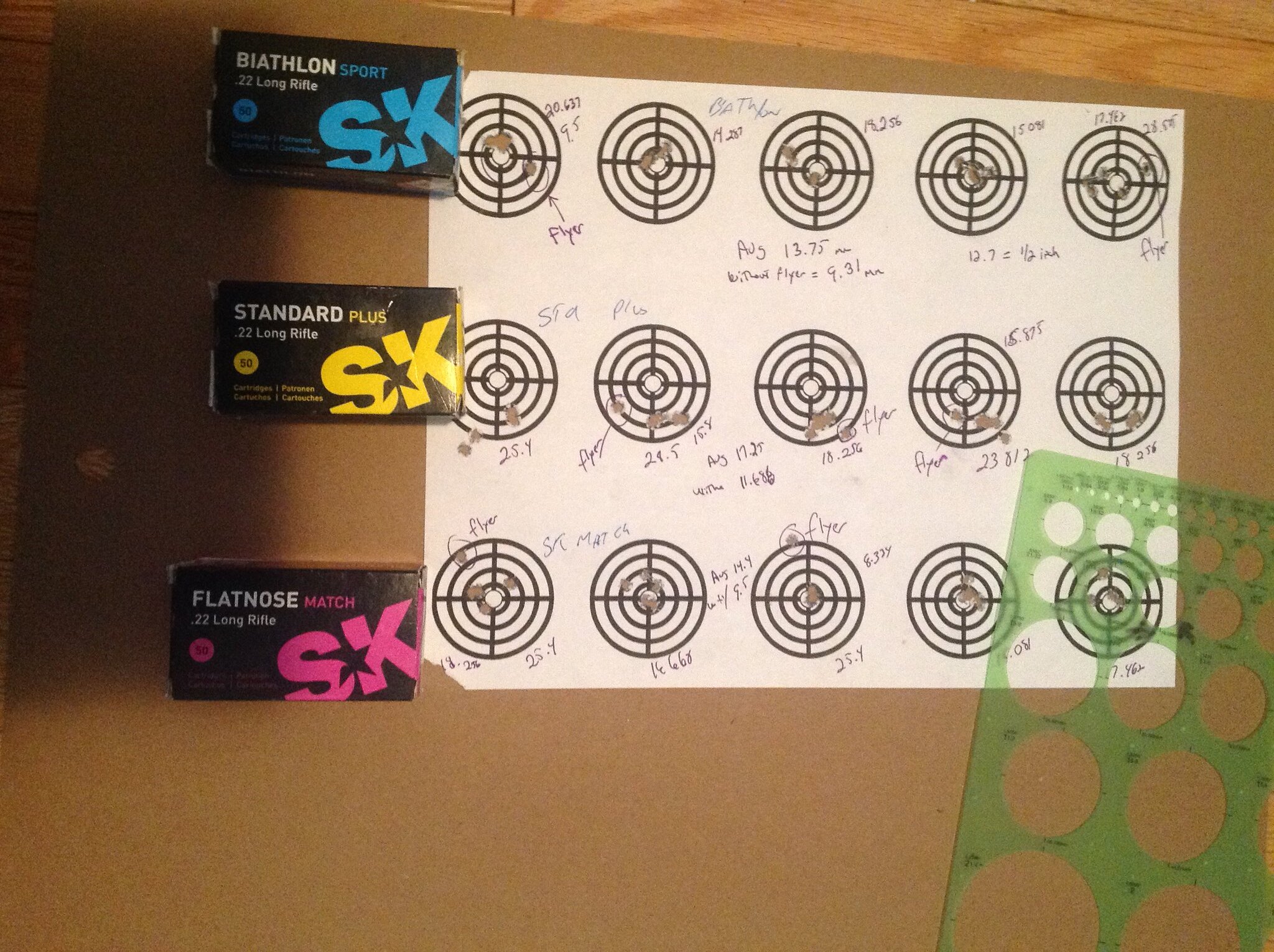

Spent the morning on the range testing SK ammo.
Today's targets. Photo one is 50 yards 5x5 group. Smallest group was 8.687mm (14.287 mm raw) with biathlon. Averages were 13.75 mm Biathlon, 17.25mm std plus and 14.4mm match. If I exclude the obvious flyers/shooter errors, all three end up sub 1/2 at 50. Measurement on tgt are raw. The actual smallest and average are adjusted to center to center measurement.
image by fljp, on Flickr

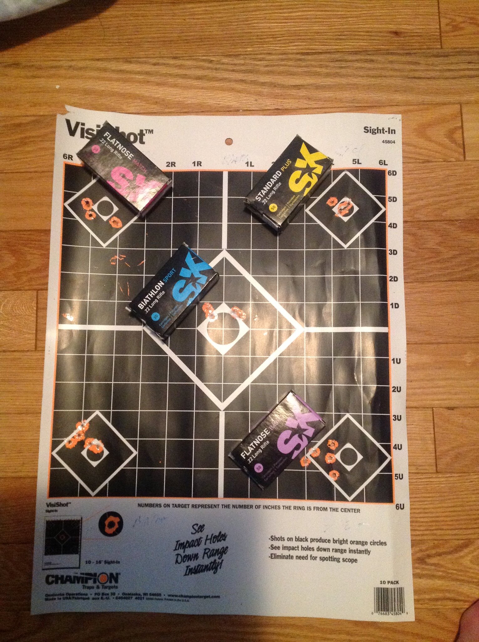

Now second tgt was at 100 yards and the std plus did amazing, it ended up grouping 12.656mm which is 1/2 Inch or 1/2 MOA at 100. Could not remember if the last tgt was Biathlon or flatnose basic
Although sample size is small, I will need to investigate further the Std plus. It has potential and was the cheapest ...Bonus

I've had good luck with the Std+ as my "good" ammo in my 455. I think the rifle match is supposed to be basically the same thing, but more consistent.
The flat nose is listed as a short range round, I used to use the sk std+ then I shot it at 200, had about 10
Inches of vertical spread
way too much choices, for now I most likely will try std+, Flatnose match. Maybe rifle match but that's it, I need to develop my dope chart and playing with so many different type I can't keep up.
Btw I have tried Eley tenex, Lapua Midas, lapua polar, lapua centre, Sk Flatnose basic, Sk rifle match, Sk Flatnose match, sk biathlon. Sk std+ , Eley Remington match, Eley Remington target, Eley Remington club, CCI Std vel, CCI Sub, CCI mini mag, federal bulk. Federal gold medal target, browning hpr, sellier & Belliot, Aguila std vel, Aguila sub, blazer, American eagle, Winchester. I have tried all of these in an attempt to acheive the sub moa at 50 challenge. In the end I can report that my gun can shoot sub MOA with just about any ammo except the cheap stuff ie CCI, Federal, Aguilla, S&B, Federal, Winchester etc. I have the data on all these and now realize that gun and ammo are fine, it's me who can't string 5 sub moa group at 50 in a row.
