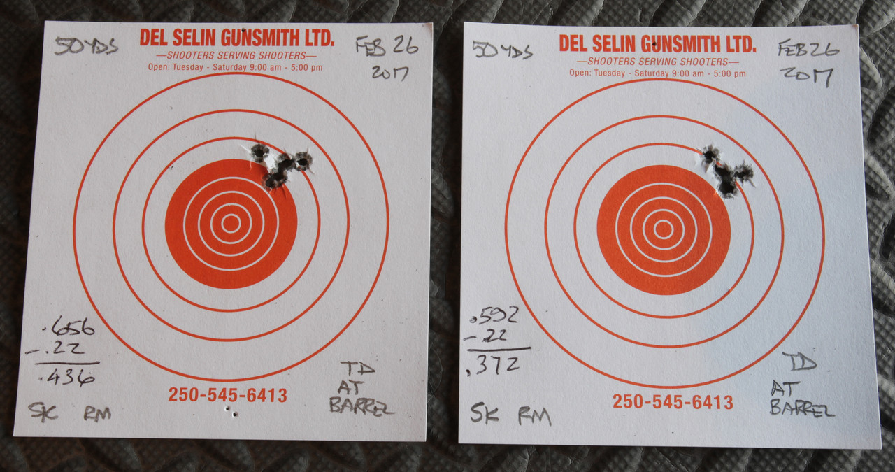

Here are 2, 50 yd targets shot with SKRM using a 10/22 Take Down and an Adaptive Tactical 9" barrel:
Here are 2, 50 yd targets shot with SKRM using a CZ 455:

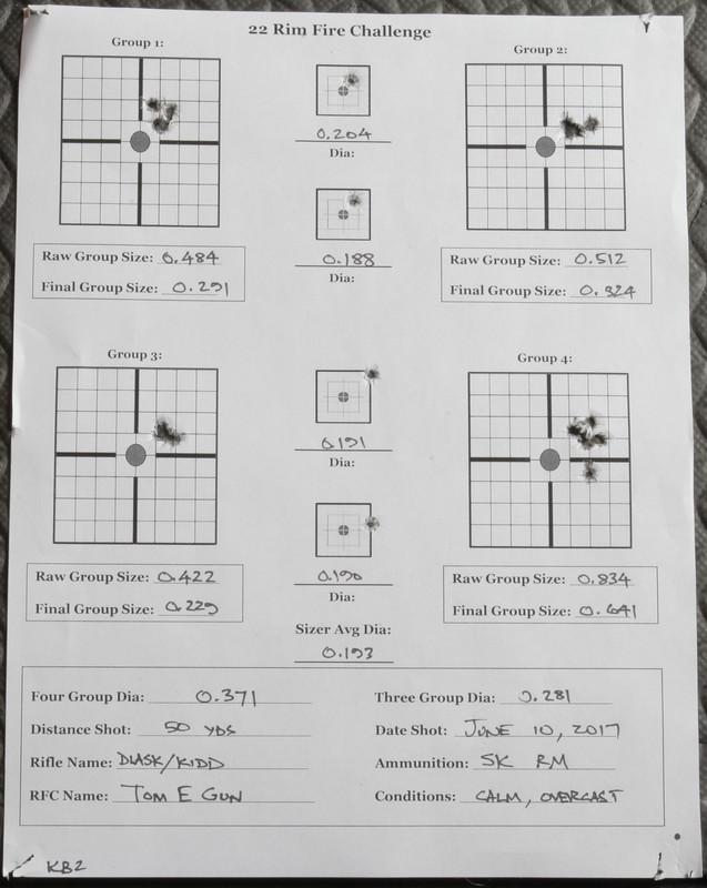

I do find I get an occasional flyer with SKRM, but at $8+/- per box rather than $25+/- per box I can live with that. Check out the bottom right target (#4) below for a real world example (in case you are wondering - in this case - the flyer was ammo related and not my oops):
This is a qualifying RFC 10/22 50 yrd game target (they allow you to average the best 3 out of 4 groups which makes it easier to qualify with cheaper ammo like SKRM). I highly recommend trying the RFC 50yd Game to anyone with a 10/22 who is having trouble qualifying with the CGN 50 yd challenge, a bit of positive reinforcement along the way is always a good thing :)
