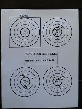

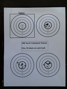

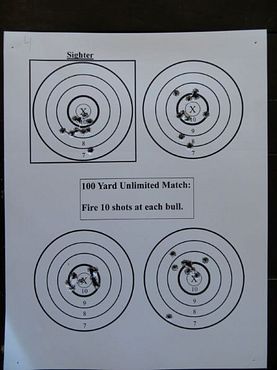

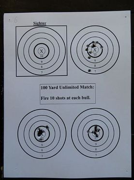

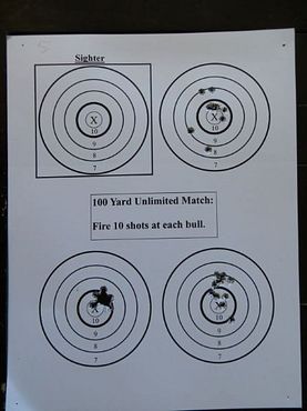

It's important for shooters to be aware that even though SK Rifle Match is "graded" as "better" than SK Standard Plus it doesn't mean that SK Rifle Match is a sure thing to be much better. Most lots should be a little better, but they are still not very consistent.
Generally speaking, all SK ammo varieties are, more or less, entry level ammos. Some cost more than others, but they should not be relied on to have great consistency, which is more and more important as distance increases.
Below are two sets of targets shot last season. They are ten shot groups at 100 yards with random lots of SK Rifle Match. All targets were shot consecutively.
Note the variation in results which means you can get some good results, but it's hard to avoid the ones that aren't. Every box of SK should be expected to have a number of rounds that don't behave as desired.
First random lot.
Second random lot.
