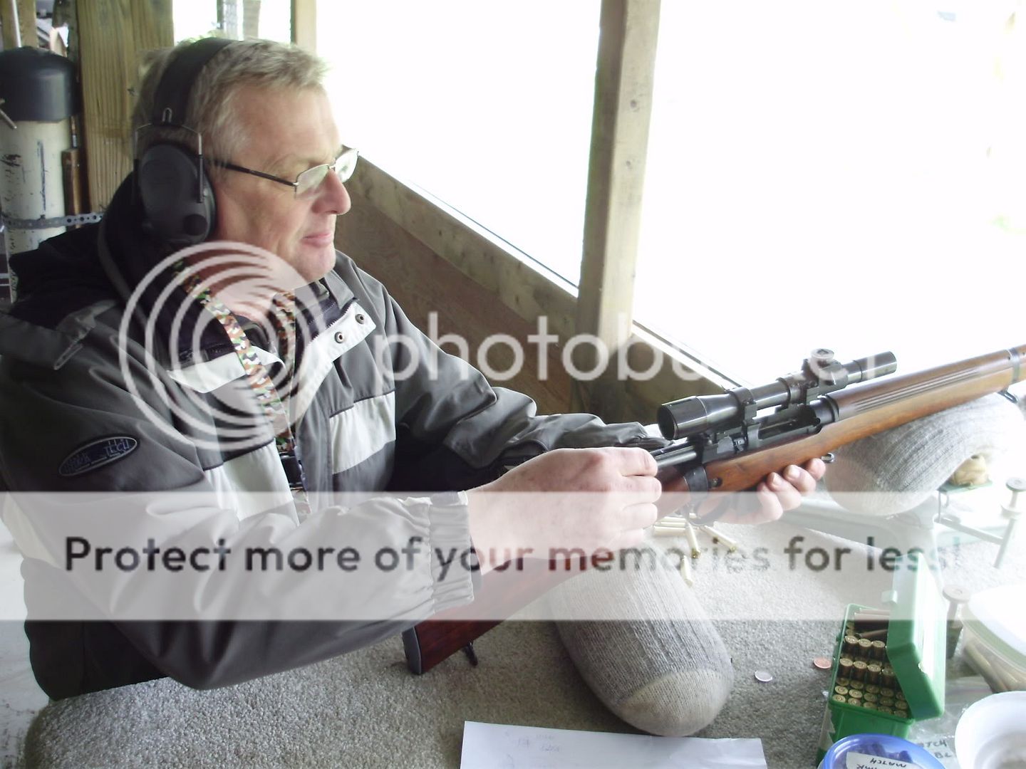

The #4T is one that was never issued. It is new. Or was was until today. now it has been shot. I note that it was made the same year I was.
Here is a better picture of it being shot by my host at the Guelph Club.
