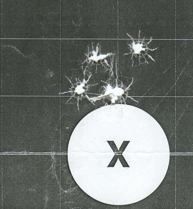

The SKS is not a benchrest rifle nor am I a benchrest shooter, so I was not sure what to expect. As the following table shows, some loads could possibly go 1.5 MOA, and some could go 10.5 MOA! Some shot to the point of aim that the rifle was zeroed to (load # 4), some shot 6” high and some shot 8 “ low. My rifle clearly likes the larger bullet diameters – the .308 caliber bullets didn’t fair too well as far as accuracy goes.

I was pleasantly surprised with three loads, as they show real potential in my rifle, remembering once again that it is a SKS and not a target rifle! The 100 grain Hornaday .312 XTP load # 2 clustered 4 shots into 2” with one flier opening the group into 4.25 “. More importantly, it shot to the same point of impact as load # 4 using 123 grain Hornaday .310 bullets, which is the load I have always prepared for hunting. Load # 2 also clustered 4 shots into 2” with one flier opening the group into 3.56”. Load # 18 placed 150 grain Speer .311 bullets approximately 1” above the point of aim. Four shots clustered into an impressive 1.5”, with one flier opening up to 2.75” – still the most accurate load of all tested.
As far as factory ammo went, the Wolf 122 grain FMJHP ammo clustered 4 shots into 3” and one flier that opened the group to 6 “, but overall – the old Norinco “silver box” ammo was the most accurate.
