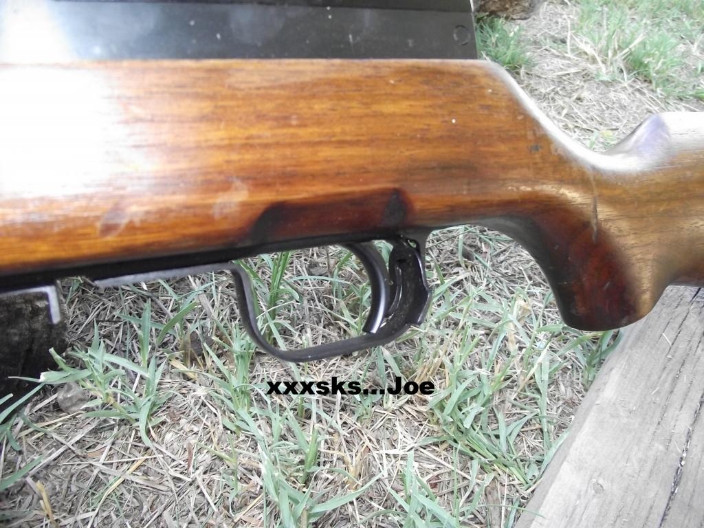

They only work on a stamped trigger group. There is a bridge of metal on the milled groups that would need to be filed off. Or, the safety would need to be filed down on that side.
I wouldn't do either. But filing on an ambi safety is better than bubba'ing a milled trigger group.
R4e42021edd1f5ce04998649029f255b0
Rd342072b12ebbaaa8d20ad00e4e6a905
This is a pic that seems to show the safety as having been modified (instead of the milled trigger group):
Then there is the issue of how there isn't a cutout on the left side of the stock for a clean sweep of the safety. That's another mod to the stock.
To be honest, they aren't all that great anyways. I can engage the safety fairly easily with my right thumb when I'm shooting.
If they were still cheap, and you had a stamped trigger group (or had one to swap out with a milled group), and didn't mind filing down on your stock, then it would be a worthwhile mod.
I've seen them selling for $70 USD now. They just aren't worth it at that price.
FYI, they were factory installed on the Polytech Hunter SKS. Notice how it also has the cutout for the safety on the left side. It is a bit of a pain to engage without that cutout.
