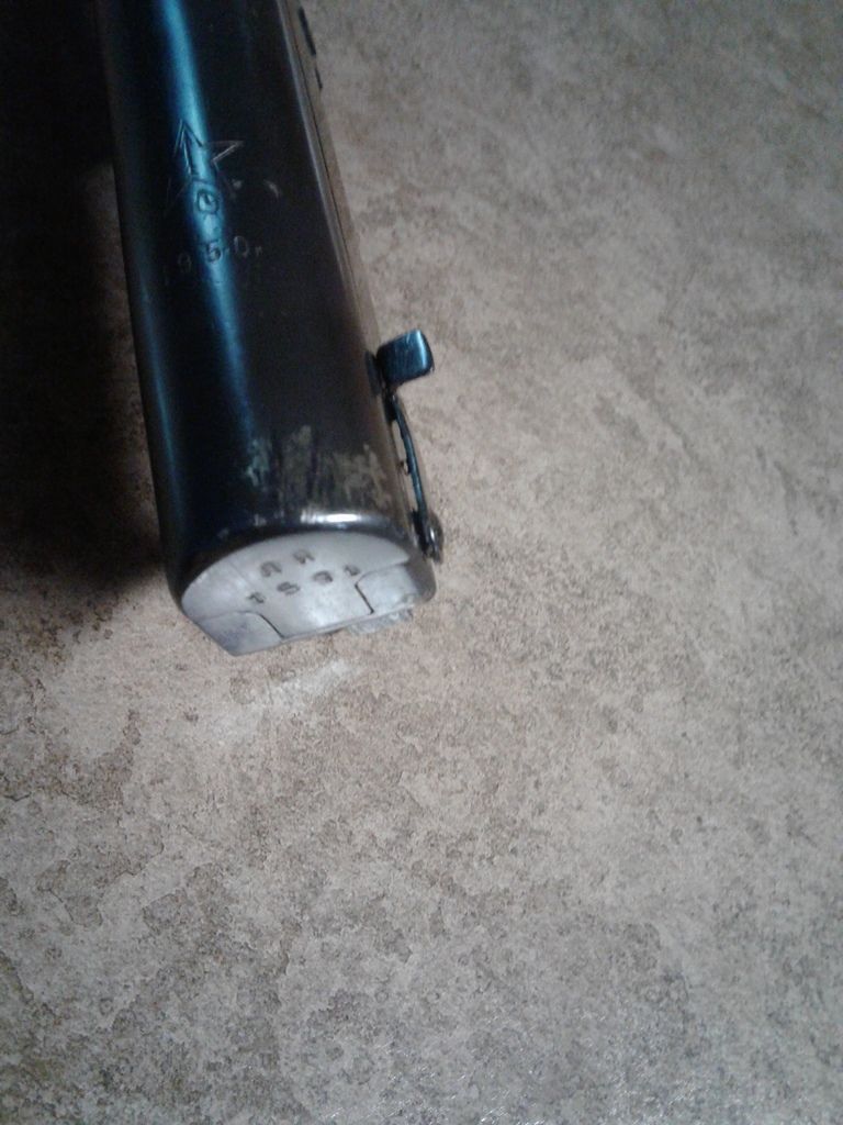

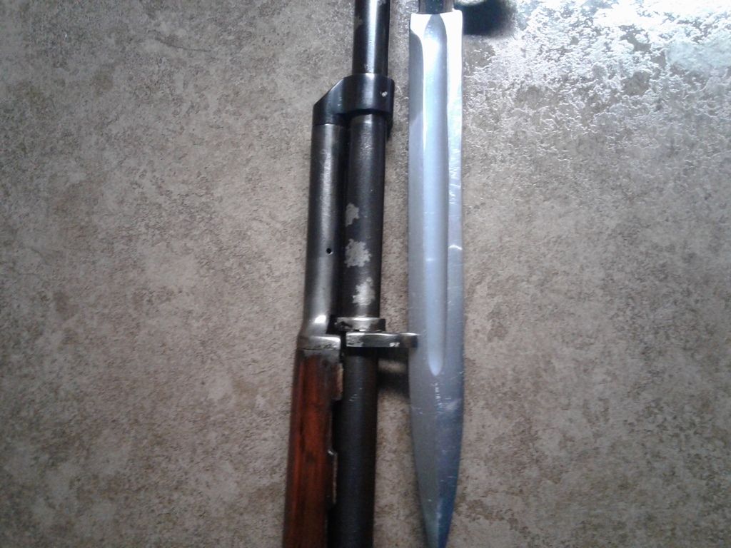

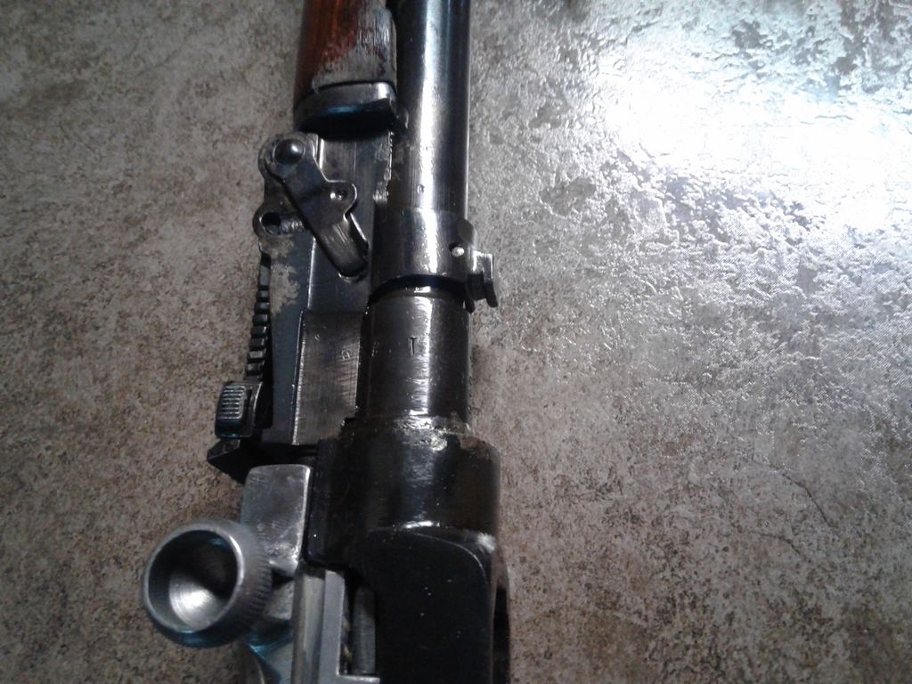

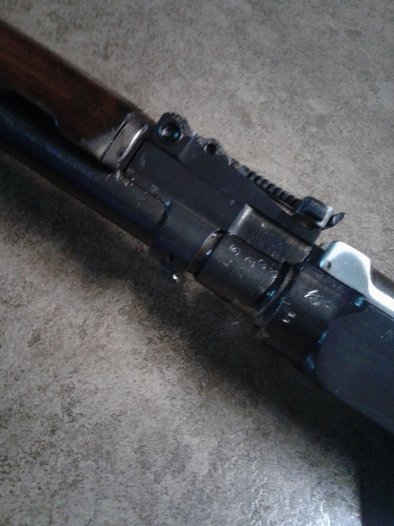

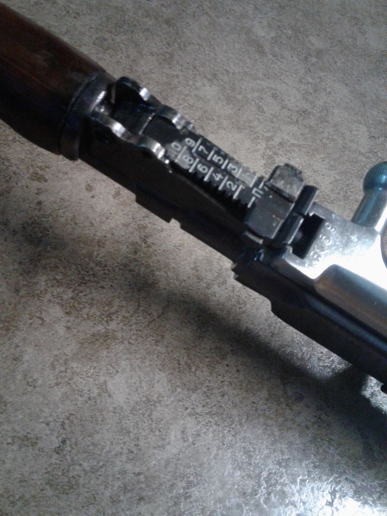

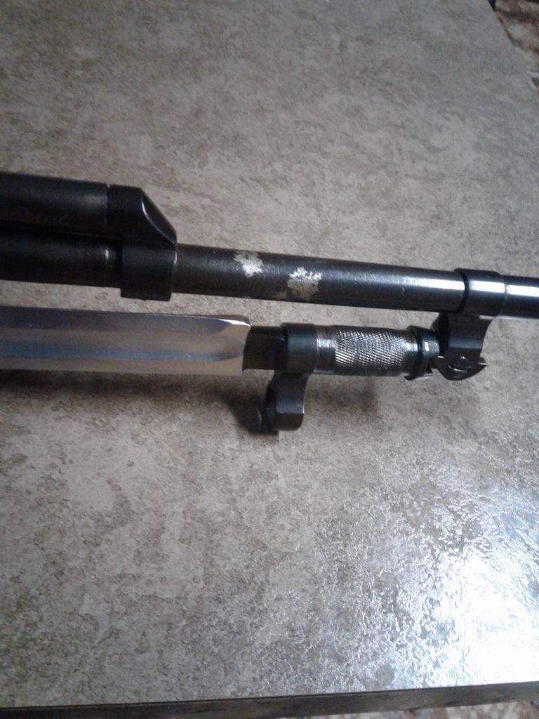

So I got a refurbish beater sks that had BBQ paint touch up everywhere, it wouldn't be so bad but it looked like this was done on a Friday, and really sloppy, so I got some de-sovent contractor solvent, sprayed all the metal down and used a brass brush in the hot bathtub and it came off easily, so now I know what they were hiding, only a bit bluing loss, and some very minor rust that I could wipe off with gun oil, and it turns out the bore was mint as well, maby I will have to redo the stock as well to clean it up nice , I could post some pics if people are interested, I just forgot to take before shots
