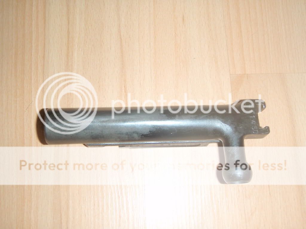

I have a very nice 1950 laminate stock (refurb) SKS with a Black bolt carrier. I really like the looks of the silver bolt models, and would like to change mine from black to silver. Are the Black bolts just silver ones painted, and if you strip the black paint off, and buff it out will it rust? Or is that all you have to do? Or is it different material, and if I wanted to make mine silver, would I have to buy a silver replacement bolt?

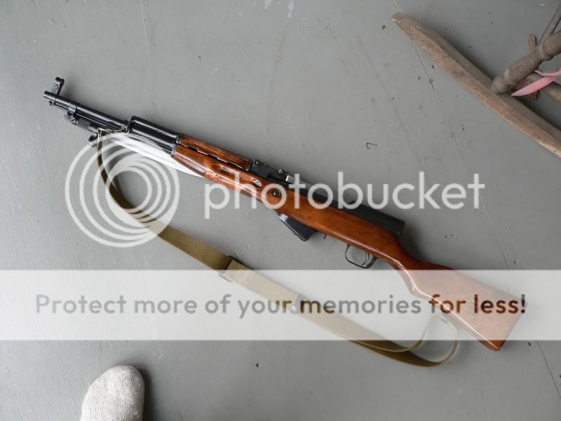

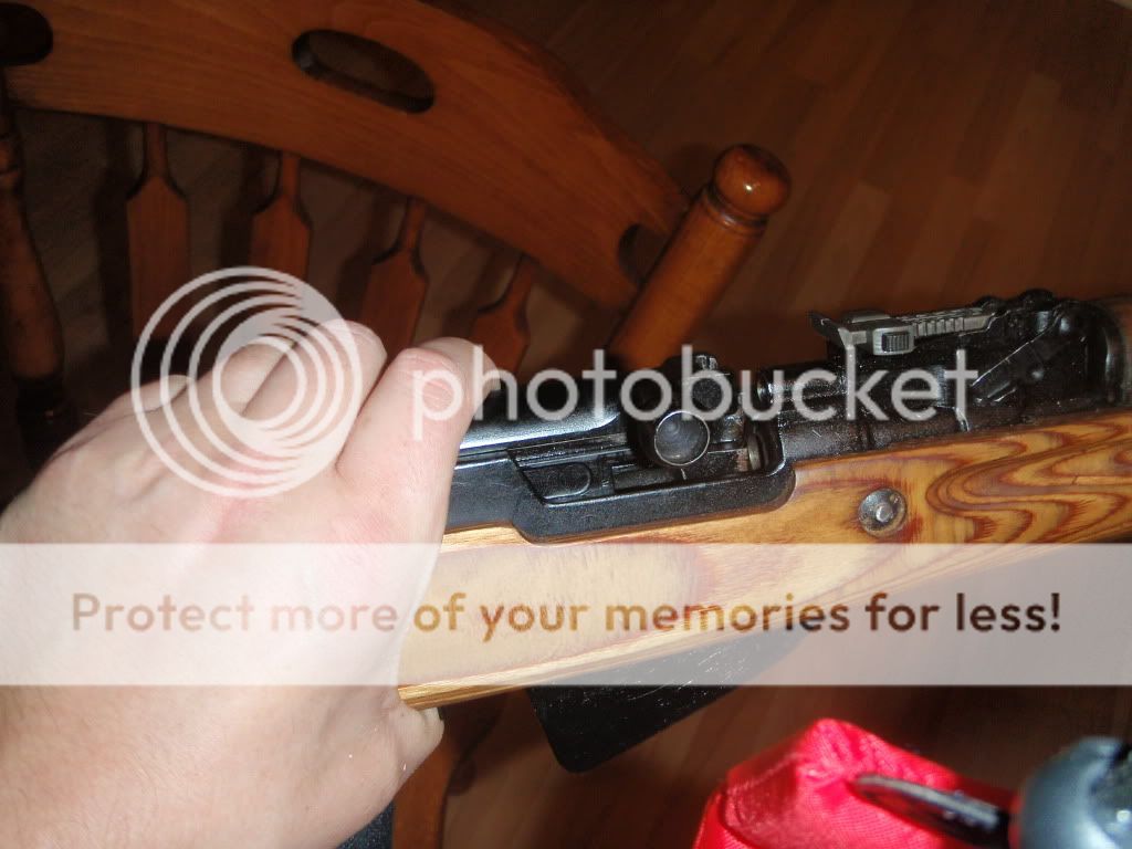

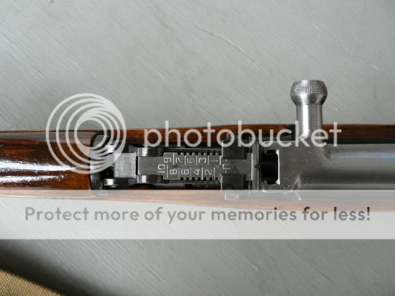

I ended up changing my bolt from black to silver last night. Here are the before and after pics
All done the transformation. I am really happy with the results. You can't really tell from the pictures but it is almost exactly the same colour of the bayonet. While I was at it I retrofit a old recoil pad I had left over from a remington model 700 BDL by sanding the bottom and rounding it off (took about 1 inch of material off it) which gave the stock about 1 1/2 inches of extra length. I was going to get a aftermarket stock for it, but the refinishing job I did on the laminate stock turned out so nice I think I will just leave it as it is.
My next upgrade will be a nice set of sights, maybe a set of willams firesights with a peep sight, and give it a trigger job.
Took me about an hour start to finish. I thought I was going to have to go to the hardware store to buy a buffing disc for my bench grinder but it didnt cost me anything because I had a Dremel tool with the wire wheel and buffing wheel. I had some rubbing compound also but I didnt notice any difference when I used it. All you need is a gold coloured wire wheel, and a buffing wheel. I just put some oil on it when I was done.
I just used some leftover "honey coloured" deck stain. I dont like the Glossy look, and the finish turned out exactly how I wanted it to.
Nice work on the bolt carrier and the stock, that thing looks great. I had a laminated one about 15 years ago that I wish I'd never sold. Gonna have to rectify that once I get my PAL again.
Those pictures made me damn sure that yes, I do want to spend the extra money on the laminated stock. :D
The place I bought mine SKS at it only cost $20 more than a hardwood stock so it was a quick decision. I liked the way it turned out so much I think I might buy another one.
