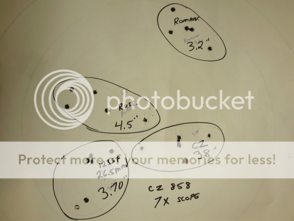

I repeated much of the testing I did two weeks ago. The Red Dot base broke near the end of the last test while I was testing muzzle brakes, so I used the opportunity to install a 7X Long Eye Relief scope. I thought a 7X scope would be more appropriate for accuracy testing than a Red Dot.
The results were almost identical. I shot 4 groups (a handload and 3 flavours of Milsurp) all shot about the same (about 3.5”), similar groups to the last test.
I like this rifle. It shoots everything quite well and is measurably better than a SKS.
