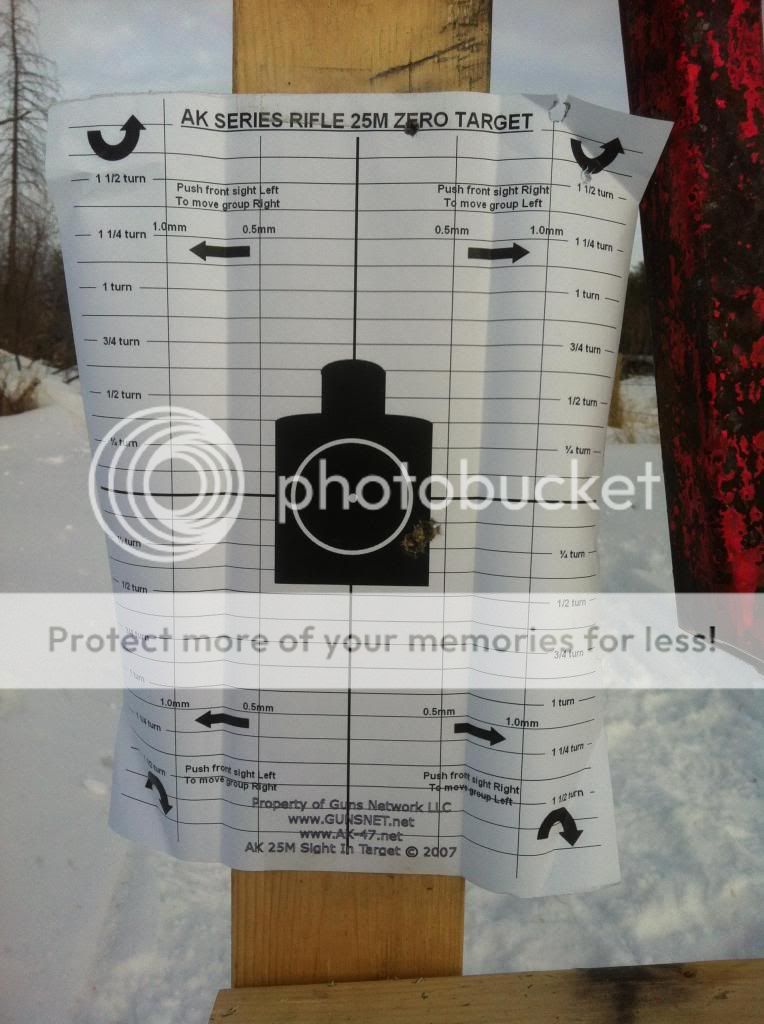

i have a CZ 858 in which i tried to use the BATTLE ZERO setting and used a AK sight in target set at 25yards.

this is the target i used on the CZ.

I put my cz at 1/4" low at 25 yards set on the Battle sight
This gives me out to 250 with a 3" deviation high and low with POA

I set all of my AK and SKS on that target at about same elevation as you do. Perhaps 1/4 " lower. Just center your group and I think you will do fine.
Are you purchasing those targets? There are a lot of non-copyrighted printable ones out there. Those were copyrighted after release and for profit cause so many use it.
I just print out how ever many I need.

The Russian Training target he is using is designed for using the battle field setting to zero with. 300meters. BUT, this is based on a full silhouette target. ie "Minute of man."
I have set rifles for this target for 100 yards. But I get ###X at 200 or above. To start out for gongs, I would use the battlefield sight setting first if you shoot over 100.
Windage will be the critical adjustment. It is said the Russians developed that target so they did not have to train each soldier at numerous meter marks.
