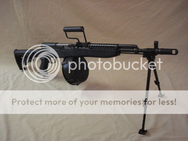

You have to make a clearance cut on both sides to clear the drum. You can see where I had to make a cut on this TAPCO stock. On the factory stock you'll need to cut that metal liner too.

Thanks for the replies, very helpful. Kingarmory that looks awesome, love the look of a drum. I won't butcher the factory thumbhole stock, think I'll get a standard "D" stock and machine it out accordingly. The LCF would be great. Thanks again!
