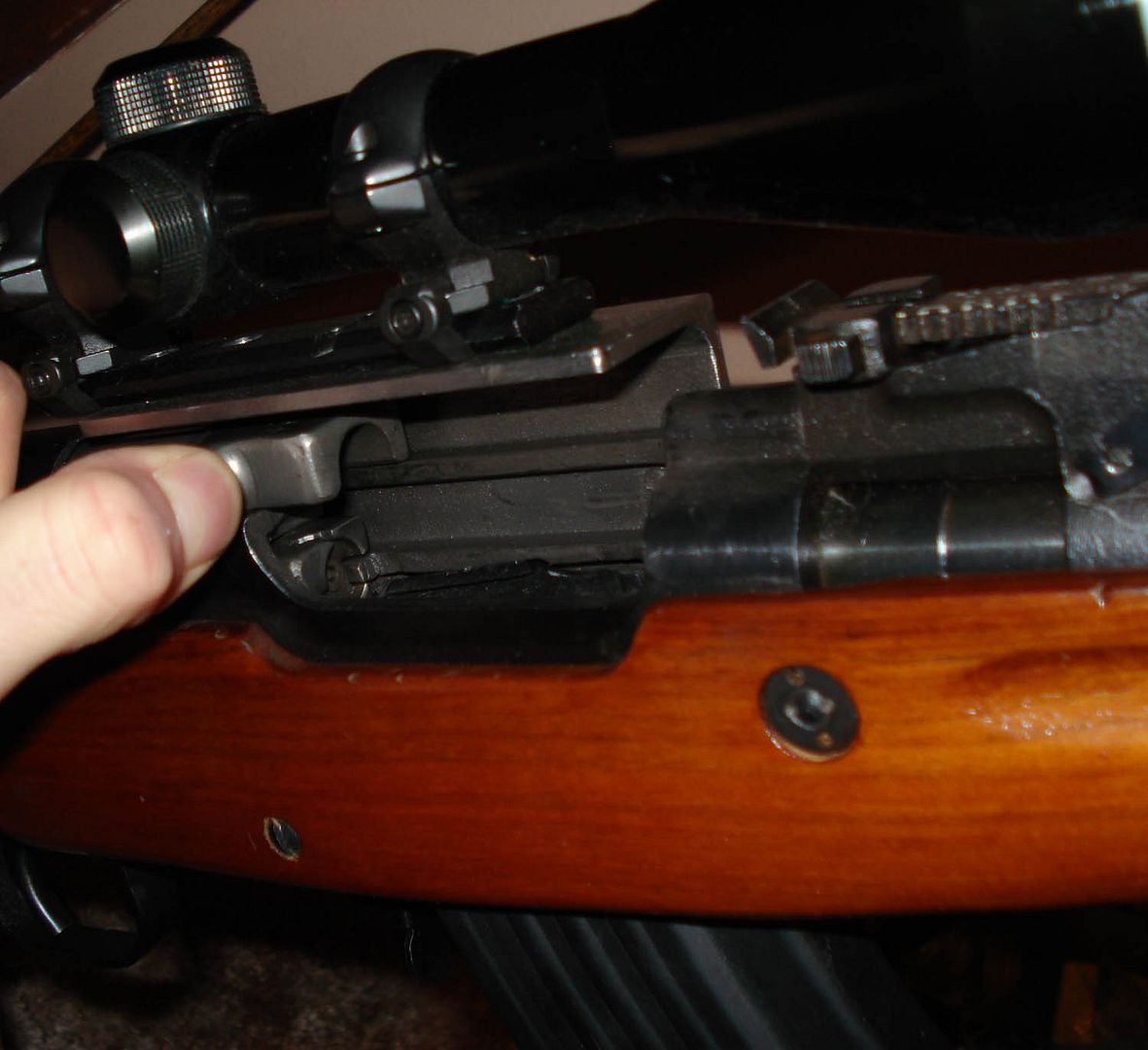

Hey Guys,
I bought a Nork SKS-D a few years back. I made my own scope mount for it because I found the Factory mounts too high for my liking (And I saved a $hit pile of $$$!).
So I've had this thing with a scope on it for a while and I take it out shooting every once in a while. What I've found is that the thing works pretty well except some times it likes to Stove pipe. This can be quite annoying. I'm assuming whats happening is that the empties are bouncing off the scope mount (it sits about 3/16" -> 1/4" off the top of the Bolt Carrier) and getting caught as it closes.
I'm kinda bored so I pulled it out of the closet and I've been playing with it for a few mins. What I've noticed is that the Extractor and the ejection unit (Whatever the hell that part of the reciever is called that knocks the casing out on the way back) are on a 45 Degree angle to the top of the reciever. In other words it looks like it's supposed to be an Angle eject!
Didn't know this!! all I've ever really noticed about firing SKSs is that they seem to launch brass straight up and out at mach 20! I figured when I put this mount on things would sort them selves out (and they have in a way) but looking at this ejection setup I'm almost thinking things should work better than they do!
So, The Questions!
1. What can I do to make this thing eject better? If it actually ejected the brass at a 45 Deg angle I would be free and clear.
2. Is there a way I can slow down the ejection speed? I'm thinkin I could solve some problems if this thing didn't wing the brass so hard. Also, the take down latch is loose and I'm thinking it could have something to to be being pounded by the recoil!

Yes sir! Solid, Cheap, only took me about an hour and $5 to get a piece of angle and have it cut. It's an SKS, I'm not puttin a $100 scope mount on it :D

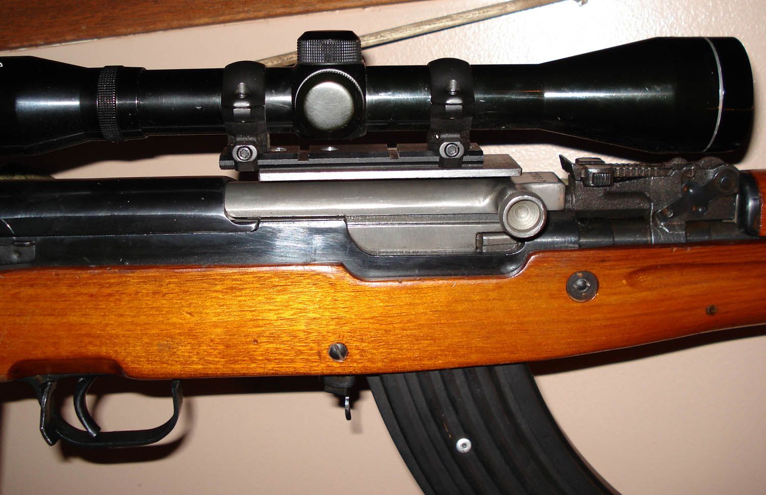

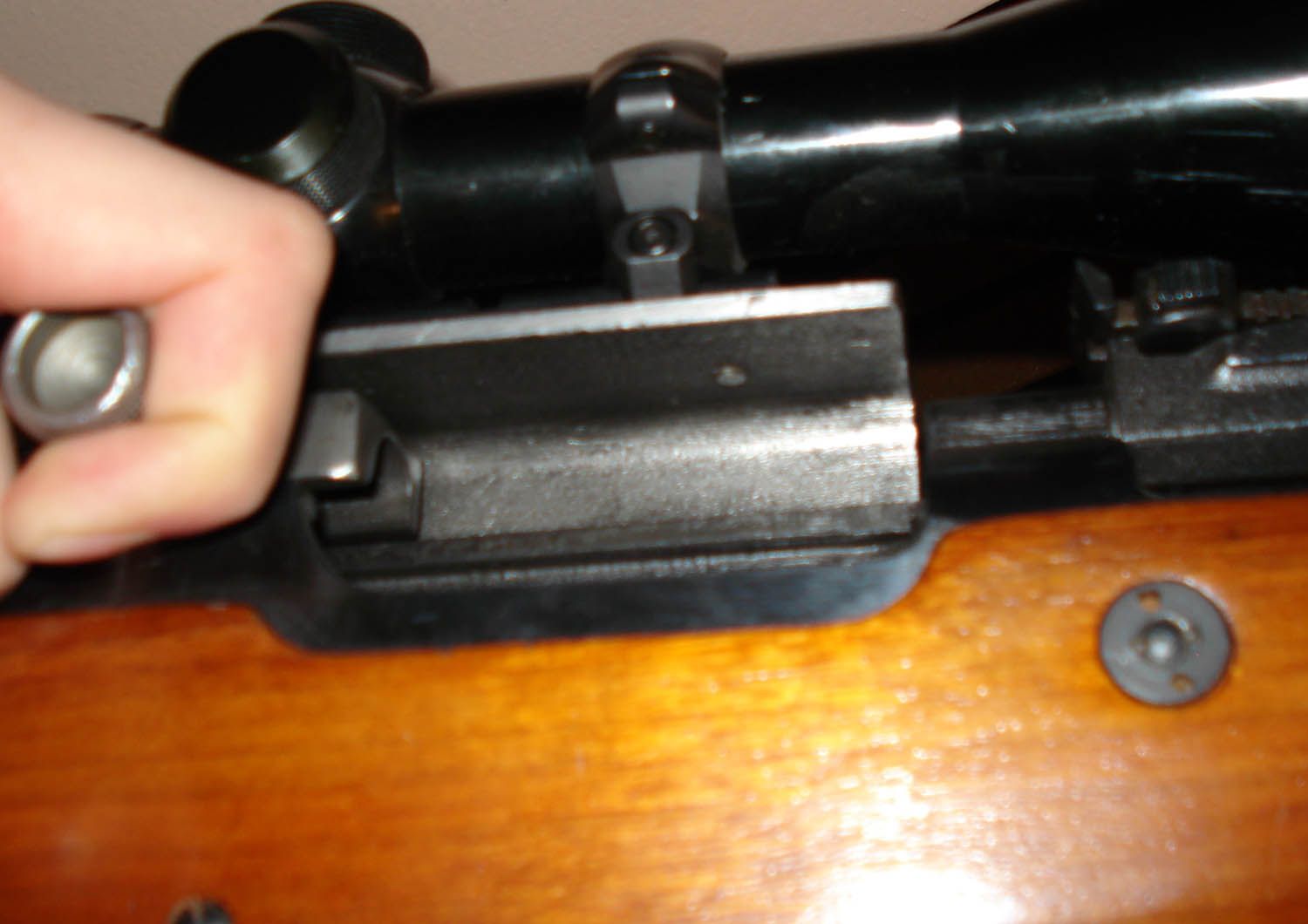

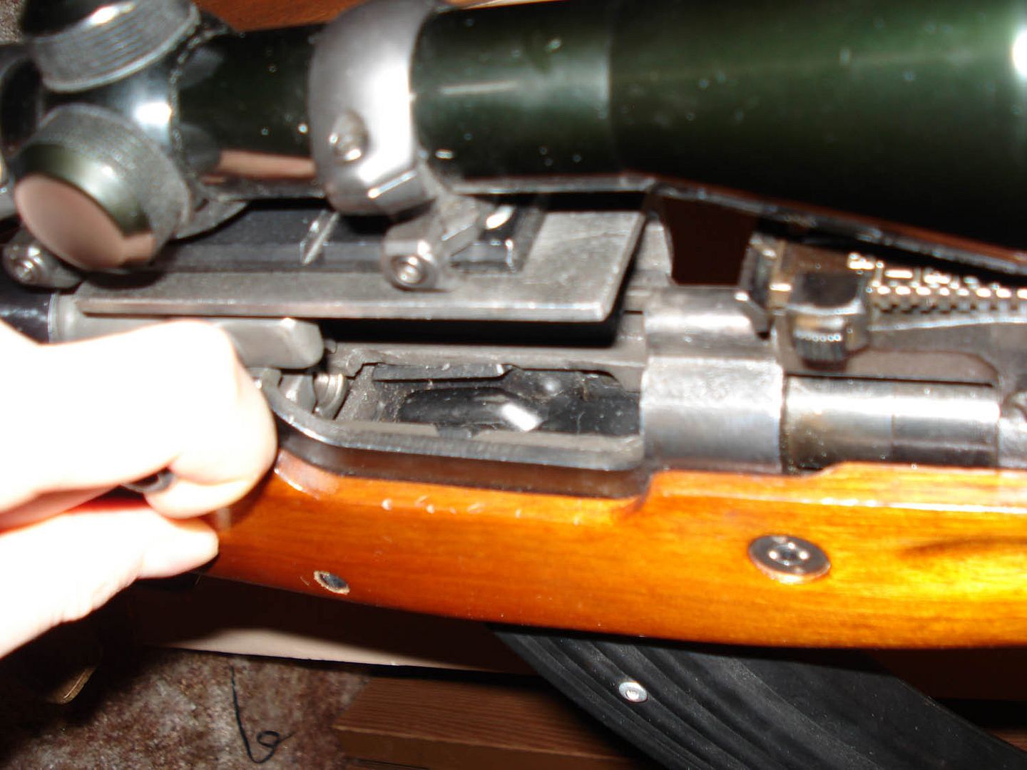

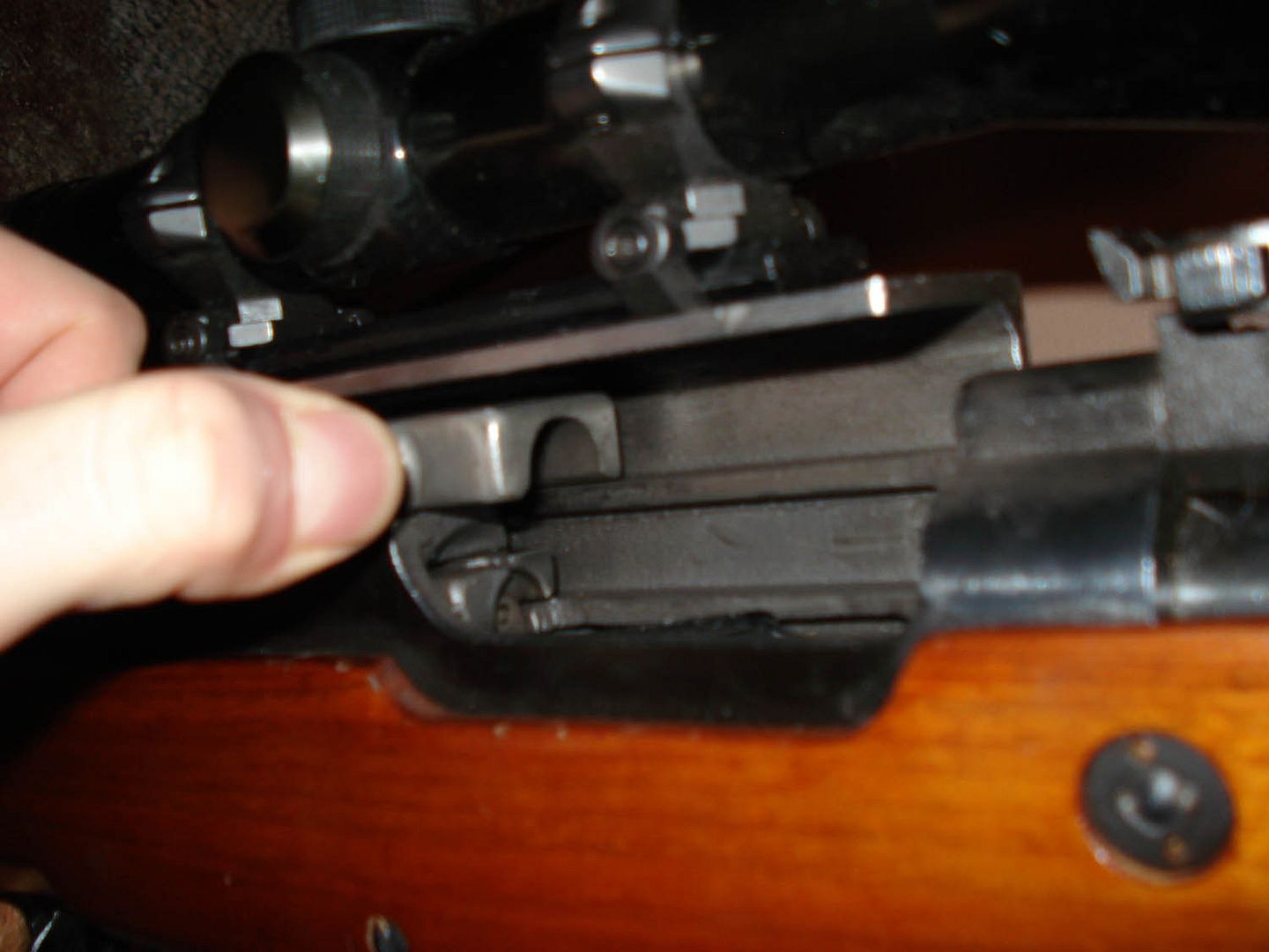

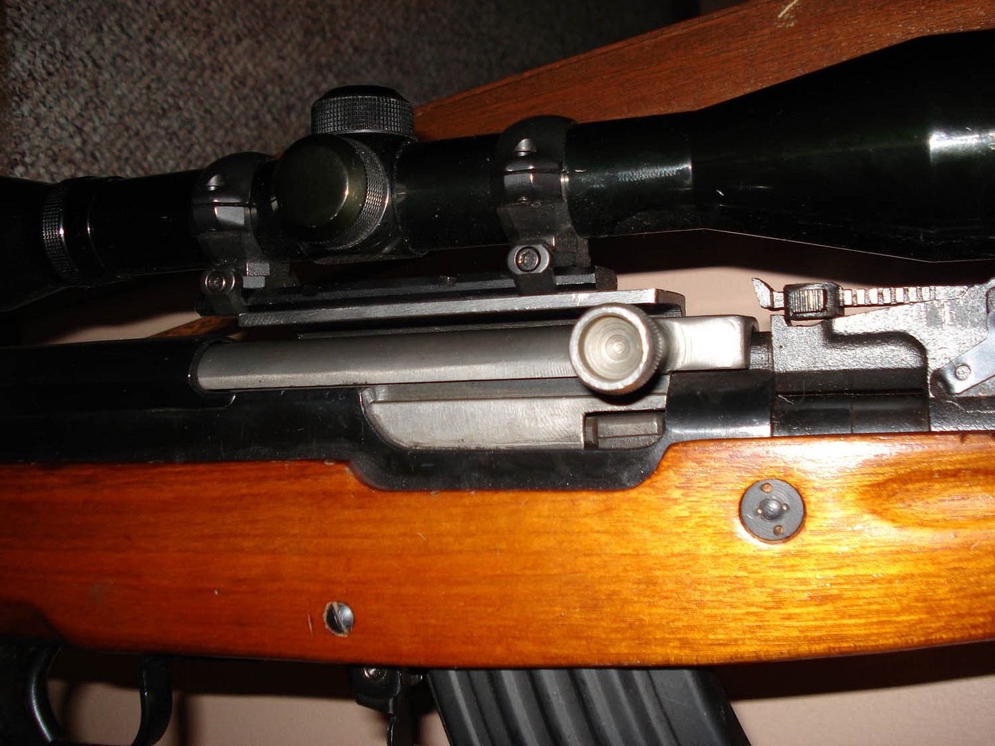

Thanks for posting the pics. The idea is excellent but in this configuration your extracted casings will unfortunately bounce back into your receiver.
My suggestion is to raise it a bit and weld a piece of sheet metal at 45 angle at the bottom of the mount. This will bounce the ejected casings out of the bolt carrier's way.

Here are some pics
I was thinking shell deflecter too but you'll see why that isn't a real option. As I said, I don't understand why it won't fling em out the side better based on the way the ejector is set up!
I would cut away the extra material you have at the right of the mount and in front. It is not doing anything useful. Maybe this may be enough for the case to clear.
There is a combination weaver rail/ shell deflector out there, I had an SKS I picked up at a Gunshow that had one on it. Sorry I do not know who sells them.
Yeah I've thought about that but I really don't want to have to muck with it. + that means my comb has to be that much higher in order to get a decent cheek weld.

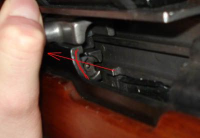

I still can't figure out why it ejects straight up with the ejection system set up the way it is. Perhaps the extracter could be modified? If it's grabbing too much on the top of the casing that would throw it up wouldn't it?
if the outlined area was removed (Or even just the lip on the underside) wouldn't it throw the brass more to the right?
You're right, that is probably a good start.
Here's an afterthough! Could it be the curved edge of the reciever deflecting the casings?
Thinkin about how fast that bolt is headin back and that the solid ejection component on the left of the reciever is the same distance from the bbl as the curved edge on the right of the reciever. Could it be playing pinball?

Looking at your pics, I see there's a good bit of metal hanging out in front that doesn't serve any other purpose than being a shelf where the ejected brass can bounce and be impeded sufficiently to be caught by the returning carrier.
Try to chop as much as you can of that useless metal, maybe even chamfer the underside too. Then try it again.
Look at the underside and the edge of your scope mount to figure where the brass is hitting.
