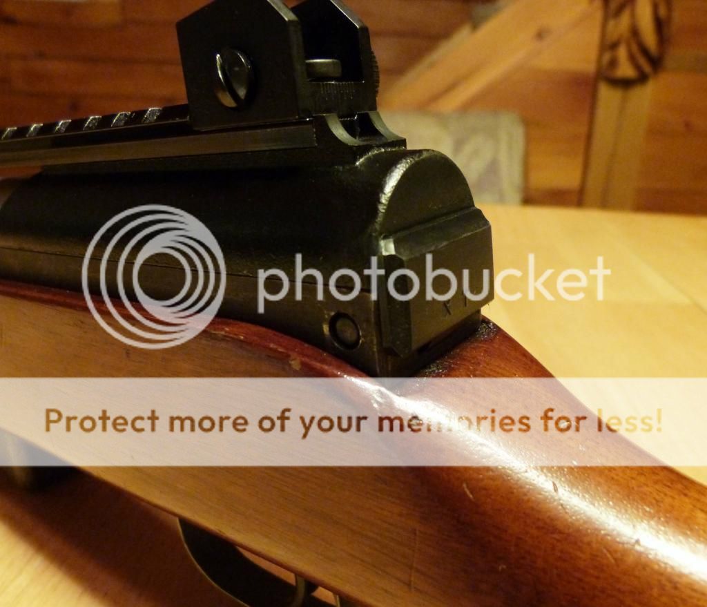

Here's what one guy did on the sideboards. He sanded the back of the receiver cover until it was flush with the receiver (it suck out a bit). Then the plate was welded to the receiver cover. That was done so that during the forward part of the recoil (bolt slamming gone), some of the shock is taken away from the front two v points.
